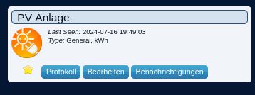

I have a small photo voltaic on my roof. For nearly two years I put the values from a shelly plug into a dummy device general usage to monitor it. The values are computed not from device.
Bildschirmfoto vom 2024-07-16 19-50-13.png (34.43 KiB) Viewed 1543 times

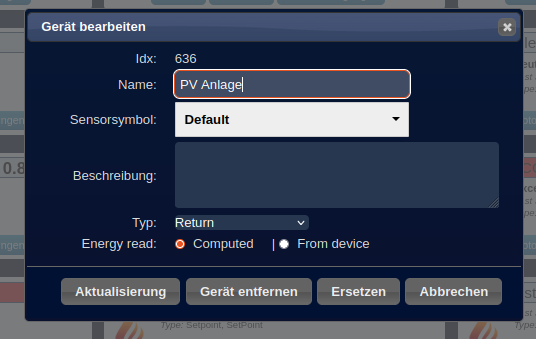

Yesterday in accident I changed from "computed" to "From device" after that all the values are gone. Even after changing back to "computed" it's still blank.Also the log is empty. I noticed that issue also in former versions of domoticz.
Bildschirmfoto vom 2024-07-16 19-49-16.png (13.69 KiB) Viewed 1543 times
Bildschirmfoto vom 2024-07-16 19-49-40.png (138.54 KiB) Viewed 1543 times
How can I rescue my data?

I see you use as virtual device Electric (instant + counter)
This virtual device requires two values.
In spite of the fact, that you set the configuration to "Computed" and not "From device", you need to send the cumulative usage.
See: https://piandmore.wordpress.com/tag/domoticz/
Electric
The electric sensor will show the current usage of electricity in Watt and the cumulative usage in kWh. You can add digits after the decimal if needed.
{"command":"udevice", "idx":1234, "svalue":"us;cu"}
where us is usage in Watt and cu is cumulative usage in Wh (even though it is displayed in kWh)
I think you should replace:
msg.payload = { "command": "udevice", "idx": 636, "nvalue": 0, "svalue":msg.payload.toString()};
return msg;
with
msg.payload = { "command": "udevice", "idx": 636, "nvalue": 0, "svalue":(msg.payload.toString() + ";0")};
return msg;
I do not know, why it has been messed up, but as you said:
The problem seems to be in domoticz when receiving wrong or no values.
This is exactly, what you were doing. So perhaps it will solve your issue
