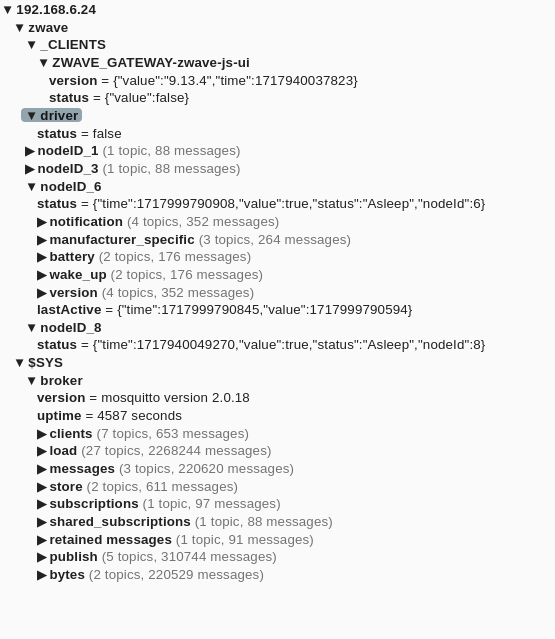

So, that is when I tried to see if it works fine with MQTT Explorer. From the looks of it, it doesn't look ok. Screen shot of MQTT Explorer shared below:
Please can someone advise what am I doing wrong.

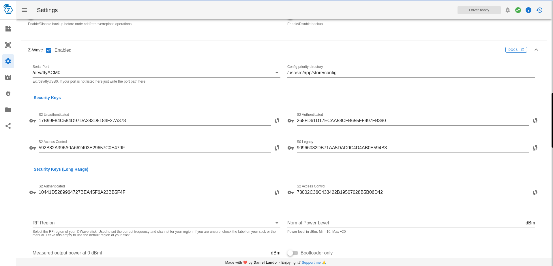

Below I have attached "zwave-js-ui" config details.
ZWAVE:

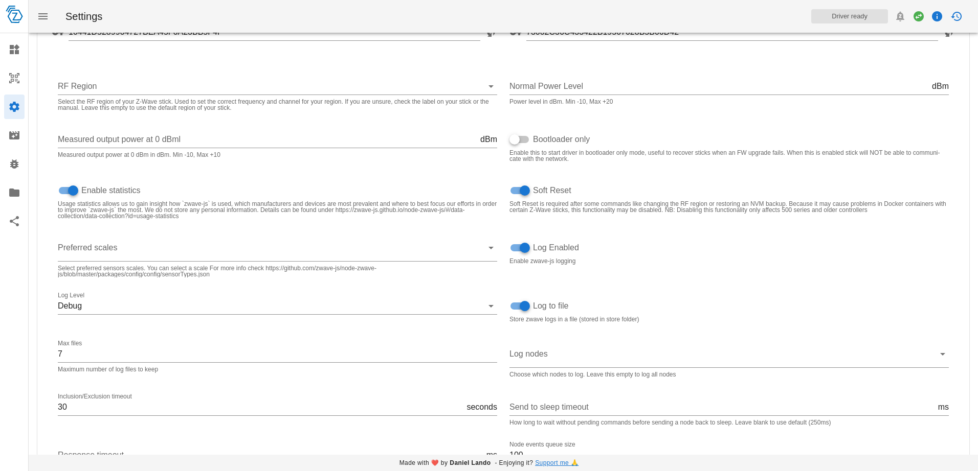

MQTT:
