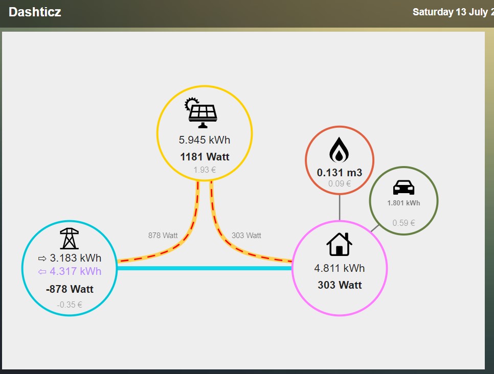

There are a few options:
* Create an energy dashboard within Dashticz
* Modify the Domoticz energy dashboard so it can be used within Dashticz within an iframe.
I've first investigated the second option.
I came with the following approach.
Add the following to custom.css for the Domoticz theme you are using.
By default this domoticz/www/styles/default/custom.css
/*changes for integration of energy dashboard into dashticz*/
.view_energy .navbar {
    display: none !important
.view_energy .container-fluid {
    padding: 0 !important;
.view_energy #copyright {
    display:none !important;
.view_energy #emain {
    width:100% !important;
    height: 100vh !important;
    margin:0px !important;
    border:0px !important;
    border-radius: 0 !important;
.view_energy body{
    padding: 0px;
.view_energy .bannercontent {
    padding:0px !important;
Add the following to your Domoticz custom.js
Normally: domoticz/www/styles/default/custom.js
var currentUrl = new URL(window.location.href);
var view = currentUrl.searchParams.get('view');
if(view) {
    //We will display the customized energy dashboard
    $('html').addClass('view_'+view.toLowerCase());
Then in Dashticz CONFIG.js define your energy dashboard block as follows:
blocks['energydashboard'] = {
    frameurl: 'http://domoticz:8080/?view=energy#/Energy',
    aspectratio:0.7,
    scrollbars: false,
This will give the following result:
Main change is that there is no Domoticz navigation bar. Further, the margins/paddings have been removed.

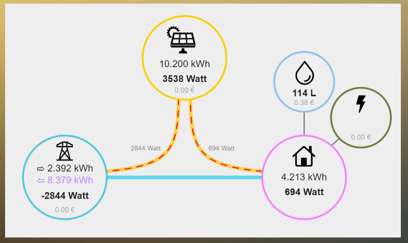

nfuse
Posts: 32
Joined: Thursday 26 March 2020 11:37
Re: dashticz block for the new Energy Dashboard
Post by nfuse »
thanks for pointing me in the right direction, i couldn't figure it out how to hide the buttons. i went a little bit further and i managed to break the domoticz template a little bij removing the background in css but that doens't matter i use domoticz only for configuring the best thing is that i have it in dashticz exactly how i want it. (for everyone thinking things are not working, after every change in css or js clear your browser history!)
i cant recall the exact things i changed because it was all trial and error but i changed the next files and used background-color:rgba(255,255,255,0.0); allot :)
www/css/style.css
www/styles/default/base.css
www/views/energy_dashboard.html
docker with sonos http api / mosquitto / zigbee2mqtt assistant / portainer / dashticz / nodeJS on windows with Zigbee2Mqtt, and some flask builds of my own
Beschuitje
Posts: 32
Joined: Saturday 24 February 2018 12:07
Post by Beschuitje »
Or you can make an iframe container with the URL of the energydash.
<!DOCTYPE html>
<html lang="en">
<head>
	<meta charset="UTF-8">
	<meta name="EnergyDash" content="width=device-width, initial-scale=1.0">
	<title>EnergyDash</title>
	<style>
		.iframeContainer{
			position: relative;
			width: 500px;
			height: 800px;
			overflow: hidden;
		.iframeContent{
			position: absolute;
			top: -170px;
			left: -150px;
			width: 800px;
			height: 600px;
	</style>
</head>
<body>
	<div> class="iframeContainer">
		<iframe width="512" height="512" src="http://domoticzip:8080/#/Energy" scrolling="no" style="-webkit-transform:scale(0.7);moz-transform-scale(0.7)" class="iframeContent" />
	<div>
</body>
Adjust the pixel values in iframecontent and scale values in the container to your own liking.
Save it as html file and put that file in the img folder of Dashticz.
Then make a frame in Dashticz config with the url to your image file.
frames.Energydash = {
	frameurl: "/img/Energydash.html",
	refresh: 5000,
	height: 276,
	scrollbars: false,
	width: 9
Config height and width and put it in a column
Not liking the white background and tried nfuse color suggestions but this doesn't work for me.
In my opinion the dash is not finished by the way. I have 2 P1 measurements (2nd for my heatpump) but only one is selectable in the dash settings
When i then select the idx of 'usage heatpump L1+L2+L3', nothing is displayed in the balloon although in domoticz values can be seen.
