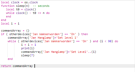

I want to switch on a lamp very slowly at 6:30 in the morning, and by that I mean that it starts at 1 percent and then burns at about 90 percent after 10 minutes.
I've tried a lot but nothing works for me.
Below I have posted the program I have now written to give you an idea of what I mean.
("Jan wakkerworden" is an dummy switch that goes on at 6:30.)
thanks in advance,
Jan

Don't use the sleep inside a script!
If you want a light to be 100% in 10 minutes, I suggest to call a script every minute
script_time_turnOnLight.lua
so if time>=6:30 and current dimmer value <100%, set dimmer to current value + 10%

Re: turning an lamp slowly on
i think this would work

yes it works!waltervl wrote: Saturday 22 June 2024 11:09 For a dzvents script you can check this topic https://www.domoticz.com/forum/viewtopic.php?t=33412

If you have Zigbee light bulbs then most of those bulb support "transition"
In a dzVents script you set transition to 60 and when you turn the lamp on it goes from 0% to whatever you have set to On position in 60 seconds.
So in dzVents only 2 commands to get it done.

When nothing works for you, you maybe do not mind that I created something in dzVents.
I think this goes in the direction of what you want?
Adapted from my t_airplanes script,where I wanted an action every xx seconds.
1. triggers on a change of your 'Jan Wakkerworden' device.
2. Checks if it is on.
3. loops from 1 to 600 seconds = 10 minutes. Schedules it with 100 steps of 6 second interval.
4. Every time sets the level 1 higher. So should end up at 100% if I am right.
NB. untested.

PS. Your while with sleep wil not work anyway, because the script can not run for more than 10 seconds.
