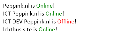

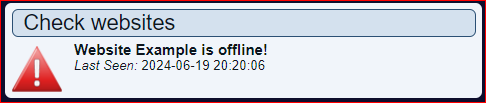

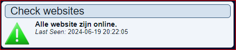

Domoticz is increasingly proving to be useful as my personal central information centre. I have therefore now also transferred control of some websites that I manage. It ensures that I am notified in a timely manner if one of those websites is unavailable for some reason.
After an afternoon of fiddling around I had it done. And in the context of 'show your projects', I want to share the result.
I use an alert device for this, while a notification is also sent by email if one of the websites is offline. I have the script running every 20 minutes.
The device is only updated when content has changed. This already makes a difference in preventing unnecessary registration. For myself, I have also included the device in a script that clears the logs from time to time, because I am not interested in longer history and also not to take up unnecessary space.
Multiple websites can be entered with URL and Name.
A maximum number of (offline sites) to be shown in the alert device is adjustable (because of the limited space). Therefore, put the most important websites first.
Site after site is called and the response processed via callback. By using the asynchronous shell command execution, you are not affected by the 10 second limitation. A fantastic invention!
To maintain an overview of the whole, a number of things are kept in variables in global_data. For explanation see DzVents wiki
The example result:
and

                    if dz.data.cw_rowCount < tableMaxRow then
                        -- Go for the next website
                        dz.data.cw_rowCount = dz.data.cw_rowCount + 1
                        dz.log( 'Checking ' .. websites[dz.data.cw_rowCount].name,  dz.LOG_DEBUG )
                        isWebsiteOnline( websites[dz.data.cw_rowCount].url )
                        --We are done looping the websites. Now check results.
                        if dz.data.cw_offlineWebsites ~= '' then
                            cw_alertLevel = dz.ALERTLEVEL_RED
                            cw_alertText = dz.data.cw_alertText
                            dz.email( notificationSubject, dz.data.cw_offlineWebsites, emailTo, 0 )
                            cw_alertText = 'Alle website zijn online.'
                            cw_alertLevel = dz.ALERTLEVEL_GREEN
                        if cw_alertText ~= cw_lastalertText then
                            -- We have new information, so update the device.
                            dz.devices(cw_alertIdx).updateAlertSensor( cw_alertLevel, cw_alertText )
-- That's All --------------------------------------------------

I have modified the script with some improvements. It was another nice puzzle.
In summary:
  • The websites are checked at adjustable intervals.
  • The website array now also keeps track of the latest status of the website, so that notifications are only sent in case of changes. Therefore, I placed the small array in persistent data (in the script itself).
  • Added trigger for 'system start'. Restart Domoticz re-initializes the array. (Necessary when sites are added or removed.)
  • Repeated attempts reduce the chance of a false negatives. Limit for max. number of retries is adjustable.
  • Alert device is only updated when content changes. Only offline sites are shown.
  • Notification is sent once. When the status of one of the sites changes. (Up or down.)
  • Notification contains the status of all sites. Some shown below as an example.
The renamed and updated script st-CheckWebsites:

                        if dz.data.cw_offlineCount > 0 then
                            if dz.data.cw_notificationTosend == true then
                                dz.email( cw_notificationSubject, dz.data.cw_notificationText, cw_emailTo, 0 )
                            dz.data.cw_alertText = 'Alle website zijn online.'

The link to the website has been added to the notification. That makes it easier to check immediately.

		if triggeredItem.isShellCommandResponse then
			--We catched the reponse.
			if triggeredItem.statusCode == 0 then
				--Command ended with success.
				if triggeredItem.trigger == 'webcheck' then
					-- Trigger = webcheck.
					if triggeredItem.data:match( "200" ) then
						-- HTTP code = 200. Site is online.
						dz.log( dz.data.cw_websites[dz.data.cw_rowCount].name .. ' is online.', dz.LOG_DEBUG )
							-- Add site status to message to send notification.
						dz.data.cw_notificationText = dz.data.cw_notificationText .. string.format( '<a href="' .. dz.data.cw_websites[dz.data.cw_rowCount].url .. '" target="_blank">' .. cw_notificationMessage, dz.data.cw_websites[dz.data.cw_rowCount].name .. '</a>', '<span style="color: green">Online</span>' ) .. '<br>'
						-- If this site was not Online before, then set online to true.
						if dz.data.cw_websites[dz.data.cw_rowCount].online ~= true then
							--Set online status to true
							dz.data.cw_websites[dz.data.cw_rowCount].online = true
							--Mark for notification because of status change.
							dz.data.cw_notificationTosend = true
						-- reset the retry counter.
						dz.data.cw_retry = 0
						-- Site is offline, or unexpected HTTP code.
						if dz.data.cw_retry < cw_maxRetries then
							--Seems offline. Give it a next try.
							dz.log( 'No HTTP 200 response from ' .. dz.data.cw_websites[dz.data.cw_rowCount].name, dz.LOG_DEBUG )
							dz.data.cw_retry = dz.data.cw_retry + 1
							dz.log( 'Retry ' .. dz.data.cw_retry .. ' for ' .. dz.data.cw_websites[dz.data.cw_rowCount].name, dz.LOG_DEBUG )
							isWebsiteOnline( dz.data.cw_websites[dz.data.cw_rowCount].url )
							--End script and wait for the isShellCommandResponse.
							return
							-- Also the retry is offline. Give up.
							dz.data.cw_offlineCount = dz.data.cw_offlineCount + 1
							dz.log( dz.data.cw_websites[dz.data.cw_rowCount].name .. ' is offline!', dz.LOG_DEBUG )
							dz.data.cw_notificationText = dz.data.cw_notificationText .. string.format( '<a href="' .. dz.data.cw_websites[dz.data.cw_rowCount].url .. '" target="_blank">' .. cw_notificationMessage, dz.data.cw_websites[dz.data.cw_rowCount].name .. '</a>', '<span style="color: red">Offline</span>' ) .. '<br>'
							if dz.data.cw_offlineCount <= cw_maxalertLines then
								--Also add site status for the device text.
								dz.data.cw_alertText = dz.data.cw_alertText .. string.format( cw_notificationMessage, dz.data.cw_websites[dz.data.cw_rowCount].name, 'Offline' ) .. '<br>'
							-- If this site was not Offline before, then set online to false
							if dz.data.cw_websites[dz.data.cw_rowCount].online ~= false then
								--Set online status to false.
								dz.data.cw_websites[dz.data.cw_rowCount].online = false
					if dz.data.cw_rowCount < cw_tableMaxRow then
						-- Go for the next website.
						dz.log( 'Checking ' .. dz.data.cw_websites[dz.data.cw_rowCount].name, dz.LOG_DEBUG )
						return
