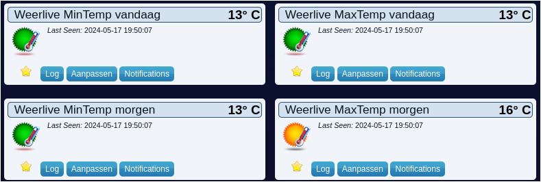

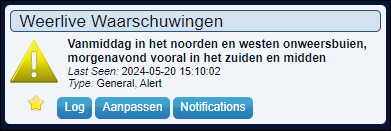

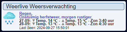

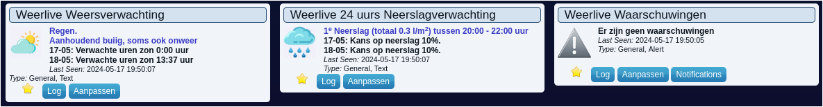

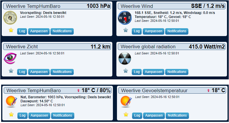

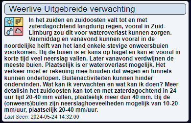

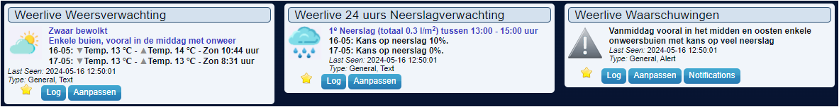

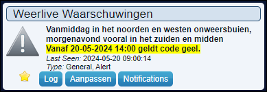

So I expanded my Weerlive.nl weather alert and now it can fill the following devices with data:
(There is optional use of devices. You can skip wat you do not need by giving them a dummy idx of 99999 in the script.)
Weather and temperature devices:
Text and Alert devides.
The script can automatically change the (optional used and defined) custom icons. These icons correspond to the possible Weerlive 'image text'.
I still have to see how I can make the (optional) icons available.

  • The Weatherforcast device gets the icon that comes with forcast tomorrow. May sometimes be a bit confusing with the text that is shown.
  • The Rainforcast device gets the icon rain or NO rain, when not expected < 24 hours.
  • The script translates mm rainfall to l/m2 which is easier to understand.

  • I noticed that under the tab Other, the device has a wordwrap. When added to dashboard this is not the case.

                        -- TempHumBaro.
                        local temp = liveweer_table[1].temp -- Also used in with the wind device.
                        if wl_thb_idx ~= 99999 then
                            local lv = liveweer_table[1].lv
                            local status = gethumstat( lv )
                            local luchtd = liveweer_table[1].luchtd
                            -- Just a quick side trip here for tomorrow's image
                            dz.log( 'Image text for tomorrow = '.. result_table.wk_verw[2].image, dz.LOG_DEBUG )
                            local image = result_table.wk_verw[2].image
                            local forecast = getforecast( image )
                            dz.log( 'Update TempHumBaro: Temp: ' .. temp .. ', Hum: ' .. lv .. ', Status: ' .. status .. ', Luchtdr: ' .. luchtd .. ', Forecast:' .. forecast, dz.LOG_DEBUG )
                            dz.devices(wl_thb_idx).updateTempHumBaro( temp, lv, status, luchtd, forecast )
                        -- Apparent temperature
                        local gtemp = liveweer_table[1].gtemp -- Also used in with the wind device.
                        if wl_gtemp_idx ~= 99999 then
                            dz.log( 'Update gTemp: ' .. gtemp, dz.LOG_DEBUG )
                            dz.devices(wl_gtemp_idx).updateTemperature( gtemp )
                        -- Wind
                        if wl_wind_idx ~= 99999 then
                            local windms = _u.round( liveweer_table[1].windms, 1 )
                            local windrgr = liveweer_table[1].windrgr
                            local windDirectionString = getWindDirectionString( windrgr )
                            --local windGust = result_table.current.wind_gusts_10m
                            dz.log( 'Update Windgr : ' .. windrgr .. ', Winddirection' .. windDirectionString .. ', Wind m/s: ' .. windms .. ', Gust: 0'  .. ', Temp: ' .. temp .. ', gTemp: ' .. gtemp, dz.LOG_DEBUG )
                            dz.devices(wl_wind_idx).updateWind( windrgr, windDirectionString, windms, 0, temp, gtemp )
                        -- Visibility
                        if wl_zicht_idx ~= 99999 then
                            local zicht = liveweer_table[1].zicht
                            dz.log( 'Update zicht: ' .. zicht / 1000, dz.LOG_DEBUG )
                            dz.devices(wl_zicht_idx).updateVisibility( zicht / 1000 )
                        -- Global radiation Watt/M2
                        if wl_gr_idx ~= 99999 then
                            local gr = liveweer_table[1].gr
                            dz.log( 'Update global radiation: ' .. gr, dz.LOG_DEBUG )
                            dz.devices(wl_gr_idx).updateRadiation( gr )
                        -- Weather alert
                        if wl_alarm_idx ~= 99999 then
                            local alarm = liveweer_table[1].alarm
                            local lkop = liveweer_table[1].lkop
                            local ltekst = liveweer_table[1].ltekst
                            local wrschklr = liveweer_table[1].wrschklr
                            local wrsch_g = liveweer_table[1].wrsch_g
                            local wrsch_gts = liveweer_table[1].wrsch_gts
                            local wrsch_gc = liveweer_table[1].wrsch_gc
                            local alertText = lkop
                            --Set the alert color
                            if wrschklr == 'rood' then
                                alertLevel = dz.ALERTLEVEL_RED
                            elseif wrschklr == 'oranje' then
                                alertLevel = dz.ALERTLEVEL_ORANGE
                            elseif wrschklr == 'geel' then
                                alertLevel = dz.ALERTLEVEL_YELLOW
                                alertLevel = dz.ALERTLEVEL_GREY
                            if wrsch_g ~= '-'  then
                                -- There is a Warning
                                if wrsch_gc == 'rood' then
                                    htmlbgColor = cRed
                                elseif wrsch_gc == 'oranje' then
                                    htmlbgColor = cOrange
                                elseif wrsch_gc == 'geel' then
                                    htmlbgColor = cYellow
                                    htmlbgColor = cWhite
                                -- Add warning time and message on new line with the warning color.
                                alertText = alertText .. '\n<span style="line-height:' .. lineHeight .. ';  background-color: ' .. htmlbgColor .. '">Vanaf ' .. wrsch_g .. ' geldt code ' .. wrsch_gc .. '.</span>'
                            -- Update the alert device with new alertLevel and alertText.
                            dz.log( 'Update Weeralarm: ' .. alertText, dz.LOG_DEBUG )
                            dz.devices(wl_alarm_idx).updateAlertSensor(alertLevel, alertText )

                        if wl_verw_idx ~= 99999 then
                            -- To calculate the expected sun hours.
                            local sunrise = dz.time.sunriseInMinutes
                            local sunset = dz.time.sunsetInMinutes
                            -- For today -------------------------------------
                            local suntimeMinutes = ( d1znperc / 100 ) * ( sunset - sunrise )
                            local sunHours = suntimeMinutes / 60
                            local integerPart, fractionalPart = math.modf( sunHours )
                            fractionalPart = _u.round( fractionalPart * 60, 0 )
                            local sunMinutes = string.format( "%02d", fractionalPart )
                            local sunTime = integerPart .. ':' .. sunMinutes .. ' uur'
                            dz.log( 'Calculated sun time today = ' .. sunTime, dz.LOG_DEBUG )
                            local d1mintemp = wk_verw_table[1].min_temp
                            local d1maxtemp = wk_verw_table[1].max_temp
                            -- arrowup = &#9650; arrowdown = &#9660; Degree celsius = &#8451;
                            local texta = d1date .. ': <span style="color: ' ..  cGrey .. '">&#9660;</span>Temp. ' .. d1mintemp .. ' &#8451; - <span style="color: ' ..  cGrey .. '">&#9650;</span>Temp. ' .. d1maxtemp .. ' &#8451; - Zon ' .. sunTime
                            dz.log( texta, dz.LOG_DEBUG )
                            -- For tomorrow ----------------------------------
                            local suntimeMinutes = ( d2znperc / 100 ) * ( sunset - sunrise )
                            dz.log( 'Calculated sun time tomorrow = ' .. sunTime, dz.LOG_DEBUG )
                            local d2mintemp = wk_verw_table[2].min_temp
                            local d2maxtemp = wk_verw_table[2].max_temp
                            local textb = d2date .. ': <span style="color: ' ..  cGrey .. '">&#9660;</span>Temp. ' .. d2mintemp .. ' &#8451; - <span style="color: ' ..  cGrey .. '">&#9650;</span>Temp. ' .. d2maxtemp .. ' &#8451; - Zon ' .. sunTime
                            dz.log( textb, dz.LOG_DEBUG )
                            -- Summary and forcast text.
                            dz.log( 'Samenvatting: ' .. samenv, dz.LOG_DEBUG )
                            dz.log( 'Verwachting: ' .. verw, dz.LOG_DEBUG )
                            local verw_text = '<span style="color: ' ..  htmlColor .. '">' .. samenv .. '\n' .. verw .. '</span>\n' .. texta .. '\n' .. textb
                            -- Update with new Text.
                            dz.log( 'Update Verwachting: ' .. verw_text, dz.LOG_DEBUG )
                            dz.devices(wl_verw_idx).updateText( verw_text )

                        if wl_rain_idx ~= 99999 then
                            -- Loop through the table. Search for the first rain occurence.
                            local tc = #uur_verw_table
                            for i = 1, tc do
                                -- if found: Rain expexted at 'uur'
                                -- else: No rain expected until (last time found.)
                                local neersl = uur_verw_table[i].neersl
                                local hr = uur_verw_table[i].uur
                                if neersl ~= 0 then
                                    countRain = countRain + neersl
                                    local unixTime = dz.time.dateToTimestamp( hr, 'dd-mm-yyyy hh:MM' )
                                    if firstRain == 'norain' then firstRain = dz.time.timestampToDate( unixTime, 'hh:MM' , 0 ) end
                                    lastRain = dz.time.timestampToDate( unixTime, 'hh:MM' , 3600 ) -- is the next hour.
                                    if firstRain ~= 'norain' then
                                        -- neersl == 0 after first episode of rain, so exit the loop.
                                        break
                                rainText = 'Geen neerslag verwacht < 24 uur'
                                dz.log( rainText, dz.LOG_DEBUG )
                                rainText = '<span style="color: ' ..  htmlColor .. '">1<sup>e</sup> Neerslag (totaal ' .. countRain .. ' l/m<sup>2</sup>) tussen ' .. firstRain .. ' - ' .. lastRain .. ' uur</span>'
                            local rainTexta = d1date .. ': Kans op neerslag ' .. d1nslperc .. '%.'
                            dz.log( rainTexta, dz.LOG_DEBUG )
                            local rainTextb = d2date .. ': Kans op neerslag ' .. d2nslperc .. '%.'
                            dz.log( rainTextb, dz.LOG_DEBUG )
                            dz.log( 'Update Regenverwachting: ' .. rainText .. '\n' .. rainTexta .. '\n' .. rainTextb, dz.LOG_DEBUG )
                            dz.devices(wl_rain_idx).updateText( rainText .. '\n' .. rainTexta .. '\n' .. rainTextb )
                            if wl_icons_installed == 1 then
                                if rainText == 'Geen neerslag verwacht < 24 uur' then
                                    local iconNumber = getIconNumber( 'geenregen')
                                    dz.devices(wl_rain_idx).setIcon(iconNumber)
                                    -- Get rain icon
                                    local iconNumber = getIconNumber( 'regen' )

Nice presentation of data, nice that the weather alarm is integrated. Separate temperature devices for the maximum and minimum temperatures of today and tomorrow would be a nice addition.
janpep
Posts: 324
Joined: Thursday 14 March 2024 10:11
Domoticz version: v2026.4
Re: Configurable 'KNMI Weerlive' script
Post by janpep »
I have considered that, but (just like with the Buienradar) it requires a lot of separate devices, while it doesn't give me any advantage.
Since I don't need to see a trend (graph) in expectations(!) and I also do not need these Min and Max temperatures as a source for use elsewhere, I wanted to keep it as compact as possible.
I have already 20 temperature devices for thermostat, radiator knobs, air conditioning, hard drives, smoke detectors etc. :lol:
I briefly considered adding a notification in the event of expected night frost (risk of slippery conditions), but my car already indicates that.

OK. In order not to pollute my production environment, I adjusted the script in my test environment. I quickly added the 4 temperature devices and tested the updated script.
When you use them fill in the idx for the min and max temperatures for today and tomorrrow.
You can connect your notifications to the devices as you like. Or you can just keep houseplants indoors. :-)
When you use them, these temperatures will disapear from the forcast device as shown in the picture below.
When you do not use them, it remains as it was with the min/max temps.
Updated script:
                        -- Visibility
                        -- Weather alert
                                    htmlbgColor = cRed

                        if wl_mintoD_idx ~= 99999 then
                            dz.log( 'Update Min. Temp toDay: ' .. d1mintemp, dz.LOG_DEBUG )
                            dz.devices(wl_mintoD_idx).updateTemperature( d1mintemp )
                        if wl_maxtoD_idx ~= 99999 then
                            dz.log( 'Update Max. Temp toDay: ' .. d1maxtemp, dz.LOG_DEBUG )
                            dz.devices(wl_maxtoD_idx).updateTemperature( d1maxtemp )
                        if wl_mintoM_idx ~= 99999 then
                            dz.log( 'Update Min. Temp toMorrow: ' .. d2mintemp, dz.LOG_DEBUG )
                            dz.devices(wl_mintoM_idx).updateTemperature( d2mintemp )
                        if wl_maxtoM_idx ~= 99999 then
                            dz.log( 'Update Max. Temp toMorrow: ' .. d2maxtemp, dz.LOG_DEBUG )
                            dz.devices(wl_maxtoM_idx).updateTemperature( d2maxtemp )
                            local texta = ''
                            if wl_mintoD_idx ~= 99999 and wl_maxtoD_idx ~= 99999 then
                                texta = d1date .. ': Verwachte uren zon ' .. sunTime
                            local textb = ''
                            if wl_mintoM_idx ~= 99999 and wl_maxtoM_idx ~= 99999 then
                                textb = d2date .. ': Verwachte uren zon ' .. sunTime
                                -- Update icon for tomorrow forecast.
                                local image = wk_verw_table[2].image
                                local iconNumber = getIconNumber( image )
                                dz.devices(wl_verw_idx).setIcon(iconNumber)
                        dz.log( 'No wk_verw_table found', dz.LOG_ERROR )
                    ---- UUR_VERW ----------------------------------
                    local uur_verw_table = result_table['uur_verw']
                    if type(uur_verw_table) == "table" then
                        dz.log( 'uur_verw_table: type = ' .. type(uur_verw_table), dz.LOG_DEBUG )
                        -- The data we get is for 24 hr, starting from next whole hour:
                        --"uur": "13-05-2024 21:00",
                        --"timestamp": 1715626800,
                        --"image": "wolkennacht",
                        --"temp": 20,
                        --"windbft": 2,
                        --"windkmh": 7,
                        --"windknp": 4,
                        --"windms": 2,
                        --"windrgr": 130,
                        --"windr": "ZO",
                        --"neersl": 0,
                        --"gr": 6
                            for i = 1, tc do
                                if neersl ~= 0 then
                                        break
                                    -- Get rain icon
                        dz.log( 'No uur_verw_table found', dz.LOG_ERROR )
                    dz.log( 'No result_table found', dz.LOG_ERROR )
			    dz.log( 'Item or JSON - NOT OK', dz.LOG_ERROR )

Here an example of the announcement of a 'code yellow'.
For now moment alarm == 0, but alert code is announced for 14:00 hr.
So, at 14:00 hour, when the alarm = 1, the alert will be set.
It's a choice. I had also considered setting the alert the first time the announcement comes but then there is no clear signal that it does not yet apply at this moment. That's why I kept the alarm status ( 0 or 1) leading.
As a result I have chosen to give it a colorcode background to draw the attention.
Dz on Ubuntu VM on Proxmox behind FRITZ!Box.
EvoHome; MELCloud; P1 meter; Z-Stick GEN5; Z-Wave-js-ui; Sonoff USB-Dongle Plus-E; Zigbee2Mqtt; MQTT; Greenwave powernodes 1+6; Fibaro switch, plugs, smoke; FRITZ!DECT 200. Scripts listed in profile interests.
janpep
Posts: 324
Post by janpep »
And then when that time has come:

I received a tip and also added the extended text of the weather forecast as an optional text device.
With a manipulation of the text because there is often a space missing after a sentence and for better readability I also added a little bit of extra line height.
It is a block of text that does not read very nice, but you have it.
Here the updated script.

                        -- Weatherforcast extensive text
                        if wl_txt_idx ~= 99999 then
                            --Space after sentences is often missing. Add a space to puntcation.
                            ltekst = string.gsub( ltekst, "(%.)", "%1 " )
                            ltekst = string.gsub( ltekst, "(%?)", "%1 " )
                            --Replace double spaces by one space.
                            --ltekst = string.gsub( ltekst, "%s%s", "%s" )
                            dz.log( 'Update extensive Text: ' .. ltekst, dz.LOG_DEBUG )
                            dz.devices(wl_txt_idx).updateText( '<span style="line-height:' .. lineHeight .. '">' .. ltekst  .. '</span>' )
                        -- Weather alert
                                    htmlbgColor = cRed
                        -- Summary and forecast used for wl_verw_idx
                        samenv = liveweer_table[1].samenv
                        verw =  liveweer_table[1].verw
                        dz.log( 'No liveweer_table found', dz.LOG_ERROR )
                            local texta = ''
                            local textb = ''
                            for i = 1, tc do
                                if neersl ~= 0 then
                                        break
                                    -- Get rain icon

Updated script with some additions:
-- 30-05-2024 Added call to function trimLRspaces in global_data.
--            Added wl_hideNowarning. When active (=1) hide device when there is no warning.
I look every day to an alert device and an extended text device both of which tell me there are no warnings.
I played with the option to hide a device from the script, which I had never done before, and I think I like it.
With the idea to show it only when there is a warning, I tried it.
So I added a variable that can be set for optional hiding of device when there is no warning to show.
If the variable is set to 1 and the "no warning texts" are present, the devices will be hidden. When the situation changes, then they become visible again.
Be aware that a refresh is required while you have the page open and the 'hidden status' changes.
Also I noticed varying behavior regarding text with leading or trailing spaces. For that I added a trim function under in global_data under helpers.
The function 'trimLRspaces' to put in in global_data:

			dz.openURL({
				url = 'https://weerlive.nl/api/weerlive_api_v2.php?key=' .. wl_apikey .. '&locatie=' .. lat .. ',' .. long,
				method = 'GET',
				callback = 'weerlive'
	    if (triggeredItem.isHTTPResponse) then

                        --"wrsch_gc": "geel"
                        -- TempHumBaro.
                        -- Wind
                            local windDirectionString = _h.getDirectionfromDegree( windrgr )
                        -- Visibility
                            ltekst = string.gsub( ltekst, "etails", "etails " )
                            ltekst = string.gsub( ltekst, "etails :", "etails: " )
                            ltekst = string.gsub( ltekst, "etails ", "etails: " )
                            ltekst = string.gsub( ltekst, "  ", " " )
                            ltekst = _h.trimLRspaces( ltekst )
                            dz.log( 'Update extensive Text: "' .. ltekst .. '"', dz.LOG_DEBUG )
                            if wl_hideNowarning == 1 and ltekst == 'Er zijn momenteel geen waarschuwingen van kracht.' then
                                -- set hidden.
                                if string.sub( dz.devices(wl_txt_idx).name, 1, 1) ~= '$' then
                                    dz.log( 'Set ' .. dz.devices(wl_txt_idx).name .. ' hidden!', dz.LOG_DEBUG )
                                    dz.devices(wl_txt_idx).rename( '$' .. dz.devices(wl_txt_idx).name )
                                -- set visiblle
                                if string.sub( dz.devices(wl_txt_idx).name, 1, 1) == '$' then
                                    dz.log( 'Set ' .. dz.devices(wl_txt_idx).name .. ' visible!', dz.LOG_DEBUG )
                                    dz.devices(wl_txt_idx).rename( string.gsub( dz.devices(wl_txt_idx).name, '%$', '') )
                        -- Weather alert
                                    htmlbgColor = cRed
                            if wl_hideNowarning == 1 and lkop == 'Er zijn geen waarschuwingen' and wrsch_g == '-' and wrsch_gc == '-' then
                                -- set hidden.
                                if string.sub( dz.devices(wl_alarm_idx).name, 1, 1) ~= '$' then
                                    dz.log( 'Set ' .. dz.devices(wl_alarm_idx).name .. ' hidden!', dz.LOG_DEBUG )
                                    dz.devices(wl_alarm_idx).rename( '$' .. dz.devices(wl_alarm_idx).name )
                                -- set visiblle
                                if string.sub( dz.devices(wl_alarm_idx).name, 1, 1) == '$' then
                                    dz.log( 'Set ' .. dz.devices(wl_alarm_idx).name .. ' visible!', dz.LOG_DEBUG )
                                    dz.devices(wl_alarm_idx).rename( string.gsub( dz.devices(wl_alarm_idx).name, '%$', '') )
                            local texta = ''
                            local textb = ''
                            for i = 1, tc do
                                if neersl ~= 0 then
                                    -- Get rain icon

I updated the script with optional link to the weather forcast with more information and radar for the location:
-- 27-09-2024 Added optional link to forcast of city. Find this link at https://weerlive.nl/plaatsnamen.php
Therefore added two variables.
local wl_locationurl = 'https://weerlive.nl/weer.php?plaatsnaam=<yourcityasfoundatweerlive>'
local wl_uselocationurl = 1             -- 1 or 0 when wl_url is used or not.
The link is added to the first line of the forecast.
In my case a link in the first line to: https://weerlive.nl/weer.php?plaatsnaam=Alphen aan den Rijn
                                -- set hidden.
                                -- set visiblle
                        -- Weather alert
                                    htmlbgColor = cRed
                                -- set hidden.
                                -- set visiblle
                    ---- WK_VERW ----------------------------------
                    local wk_verw_table = result_table['wk_verw']
                    if type(wk_verw_table) == "table" then
                        dz.log( 'wk_verw_table: type = ' .. type(wk_verw_table), dz.LOG_DEBUG )
                        -- The data we get is for 5 days, including today:
                        --"dag": "12-05-2024",
                        --"image": "halfbewolkt",
                        --"max_temp": 18,
                        --"min_temp": 17,
                        --"windbft": 3,
                        --"windkmh": 18,
                        --"windknp": 10,
                        --"windms": 5,
                        --"windrgr": 121,
                        --"windr": "ZO",
                        --"neersl_perc_dag": 50,
                        --"zond_perc_dag": 68
                        d1date = string.sub( wk_verw_table[1].dag, 1, 5 )   -- We use only 'dd-mm'
                        d1nslperc = wk_verw_table[1].neersl_perc_dag
                        d1znperc = wk_verw_table[1].zond_perc_dag
                        d2date = string.sub( wk_verw_table[2].dag, 1, 5 )   -- We use only 'dd-mm'
                        d2nslperc = wk_verw_table[2].neersl_perc_dag
                        d2znperc = wk_verw_table[2].zond_perc_dag
                            local texta = ''
                            local textb = ''
                            local verw_text = ''
                            if wl_uselocationurl ~= 1 then
                                verw_text = '<a href="' .. wl_locationurl .. '" target="_blank"><span style="color: ' ..  htmlColor .. '">'  .. samenv .. '</span></a>\n<span style="color: ' ..  htmlColor .. '">' .. verw .. '</span>\n' .. texta .. '\n' .. textb
                        --"temp": 20,
                        --"windbft": 2,
                        --"windkmh": 7,
                        --"windknp": 4,
                        --"windms": 2,
                        --"windrgr": 130,
                        --"windr": "ZO",
                        --"neersl": 0,
                        --"gr": 6
                            for i = 1, tc do
                                if neersl ~= 0 then
                                        break
                                    -- Get rain icon
-- That's All --------------------------------------------------
