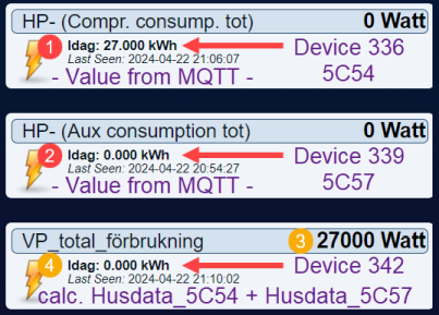

Now, I want to add these two MQTT devices (336) 5C54 + (339) 5C57 and display the total sum in device TotalActual (342) as it looks in red ring 1 and 2 in device (336) and (339).

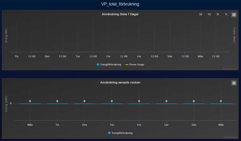

Everything in the script works but I do not see the result in kWh in device TotalActual (342) at yellow ring 4 as it appears in device (339) at red ring 2 and (336) at red ring 1 where the sum for today is displayed on row two.
Additionally, I can only see Watt value in TotalActual (342) at yellow ring 3, but no value is displayed in the graphs for device TotalActual (342). I want to see value in device TotalActual (342) as it looks in device (336) 5C54 and device (339) 5C57.

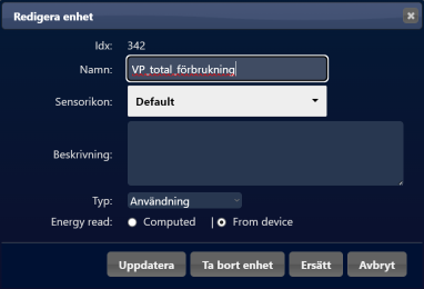

If you only need total whtoday you have to make device 342 a custom sensor and not a electricity device.
