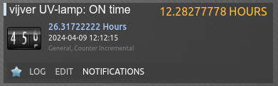

I'm trying to measure the uptime/runtime of a device.

I store this in an virtual incremental counter.
This works well but I get very big values.
I tried:
A) setting the divider to 3600. This displays the time in hours but I get a number with 8 decimal digits...
2024-04-09 uptime counter.png (30.98 KiB) Viewed 343 times
Is there a way to round this?
