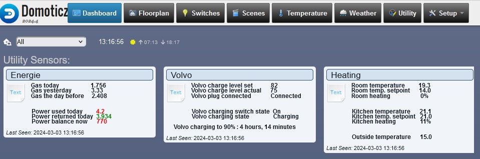

One problem I have using Domoticz ist that the senseo and actor indicators are so huge plus that these are divided in Switches, Temperature, Utility.
Of course there is Dashticz where one can customize everything.
I tried adding sensors and switches to a virtual room, but didn't like it.
The trick of handling information is that one needs just the essential information, the overview.
So I decided to create a few Text sensors containing the information I want to see in a glance and put those on the Dasboard page.
Here is the code, it is heavily commented.

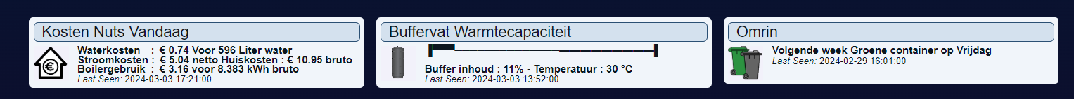

Same here, this saves enough space to get all the info i want to álmost' fit onto 1 monitor..
Utility 2.PNG (30.04 KiB) Viewed 254 times
