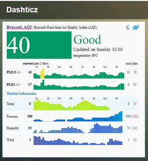

I'm trying to find a way to include an air quality widget from World Air Quality Index.
As I get the message "You can’t post image, email or url links that are external to this domain", more info in attachments.
Is there a way to get the widget in Dashticz ?
World Air Quality Index (Waqi) widget
- Waqi widget.jpeg (48.94 KiB) Viewed 3284 times

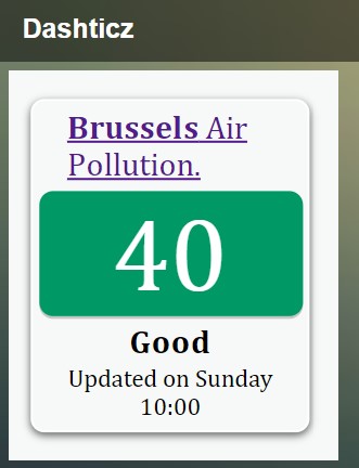

Re: World Air Quality Index (Waqi) widget
Yes
WAQI provides a few standard widgets, which are easy to integrate. I'll make a Dashticz block for these:
https://aqicn.org/widgets/wordpress/brussels/
WAQI also provides a customizable widget, which will take a bit more effort to integrate, I'll add this to the Dashticz wishlist. See:
https://aqicn.org/faq/2015-07-28/air-qu ... oved-feed/
Tks a lot for your response - I really can't wait to include the new Waqi block in my Dashticz screen !
