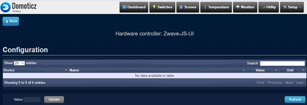

Surprise, surprise. It doesnot work again. Using a "spare" raspberry 3b+ I installing Raspbian OS, Domoticz (2024.4) and docker, mosquitto and zwave-js-ui. I was hopefull after the /opt/mosquitto location of the docker-mosquitto.y4ml file. But unfortunately. The end of the story remains an empty configuration table in te setup page of mqtt in domoticz hardware. Resulting: no devices.

Surprise surprise, you are looking in the wrong location!!!!!
https://www.domoticz.com/wiki/Zwave-JS- ... nt_gateway
After adding/updating the MQTT Client Gateway for Zwave-JS-UI the Zwave devices will be automatically added in the Domoticz device list if discovered by Zwave-JS-UI, check menu Setup - Devices. Domoticz devices will be created once data is received. So especially for battery operated devices it can take some time to have this data received. Sometimes it is possible to activate these sensors manually by pushing a button.
Hint: To add all devices at once, press "Save" in Zwave-JS-UI preferences. This will generate status messages for all devices. Or restart Zwave-JS-UI.

I have modified the Zwave-JS-UI wiki to make extra clear that the setup button of MQTT AD Hardware is used for something different then in the old OZW integration.
Note: In contrary to the old OpenZwave integration the devices/switches will not be shown in the Setup button of the MQTT Hardware Gateway but in the main Domoticz device list ( menu Setup -Devices)! Zwave Nodes etc will be managed from Zwave-JS-UI user interface on port 8091, not in Domoticz.
Note: After creation of the MQTT Autodiscover hardware in menu Setup - Hardware you can click on the setup button to configure the discovered configuration devices if they have that option using Autodiscovery Number devices. It could well be that this list is completely empty! It is used for setting preference of devices, eg detection distance, Connection interval, LED brightness etc.

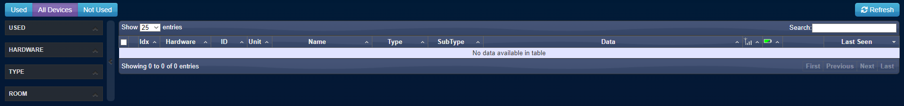

Reading the instruction better I should find my z-wave devices under devices and not under hardware. As far as I understand I should find them here:
Where am I wrong this time? Mind: I made a new installation and no conversion of the old open zwave.

Did you set MQTT to correct IP in ZwaveJS- UI (not localhost).
Did you add MQTT AD in your hardware?

I have checked, checked, dubble checked the ip-adresses. As far as i can see, they are all correct. I will ask more questions the next days, because i have doubts about the configuration in zwave-js-ui.

Check with the application MQTT Explorer (can be installed on any system in your network) if you have the topics as explained in the MQTT_AD_Report_Problems wiki, do you have a zwave and a homeassistant topic with subtopics in MQTT explorer? See also the example screenshot (showing combined zwavejsui and zigbee2mqtt topics) in the wiki:
https://www.domoticz.com/wiki/MQTT_AD_Report_Problems
Also share your Domoticz MQTT AD configuration.
