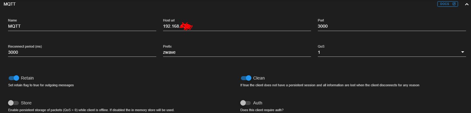

Following the Wiki: https://www.domoticz.com/wiki/Zwave-JS-UI I can now see (MQTT autodiscover) zwave devices in Domoticz and I can successfully change (physical) switch status directly through Zwavejs-UI control-panel, BUT changes in switch status and sensor measurements are not propagated to Domoticz and changing switch position from Domoticz does propagate the other way to Zwave-JS-UI and the physical Zwave device.
I suspect that I've not had (and probably still doesn't have) correct settings in Zwave-Js-UI.

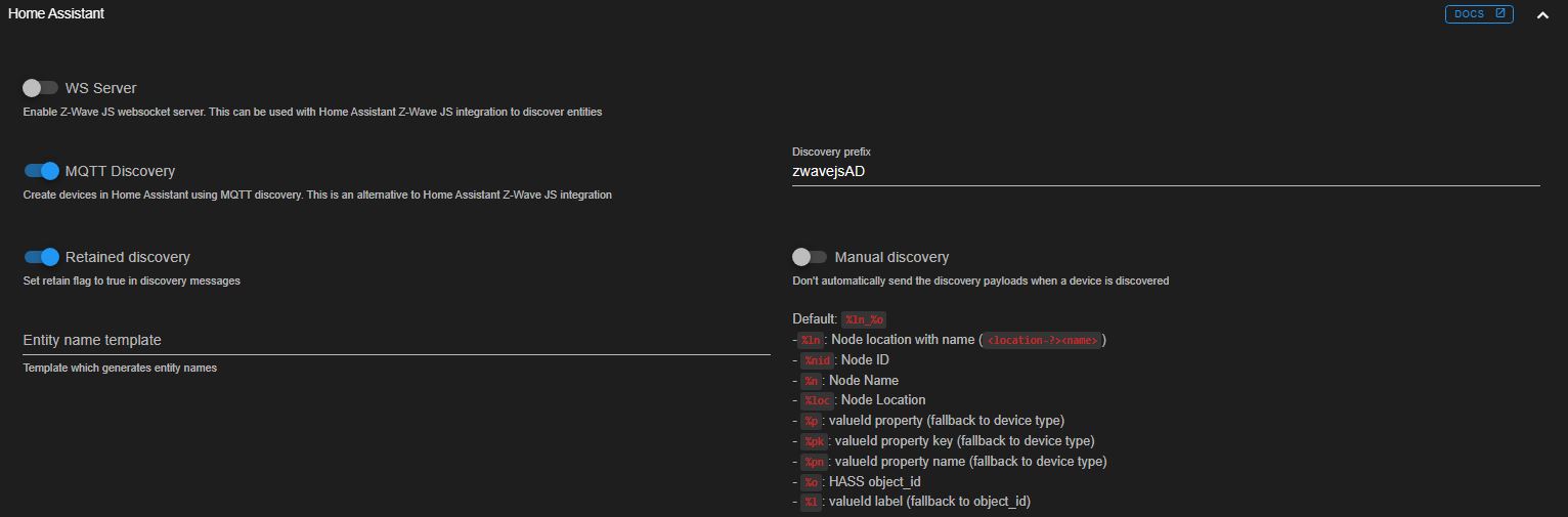

I have noted that I initially used the same text ("zwavejsAD") as MQTT-prefix in Zwavejs-UI AND as the "Zwavejs-UI - Home assistant - Discovery prefix" and the Domoticz-Hardware-Auto Discovery prefix which I've now understood is not correct, but separating the first from the other two did not solve the problem.
What is wrong with the enclosed settings:

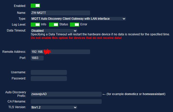

I can add that these are the Domoticz settings:

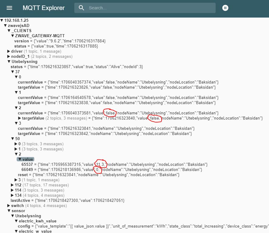

And this is how the MQTT looks from MQTT-Explorer where I expected the red marked data to change when either the Zwavejs-UI or Domoticz device switch position or physical sensor data is changed:

When using MQTT Explorer, do you see the topic/tree zwavejsAD ?
You should see topics with the names like
zwavejsAD/switch/xx/yy/config
zwavejsAD/light/xx/yy/config
But in your screenshot below, it seems i see zwave nodes with status here.
Which is odd, as in your first screenshot your prefix is been set to 'zwave'
What I suggest because you 'had' the same topic name as prefix and MQTT-AD, stop zwavejs2mqtt
Use MQTT explorer to delete the zwavejsAD (and if you have also zwave) tree, so your broker is clean
Next launch zwavejs again, you should now get 2 tree items

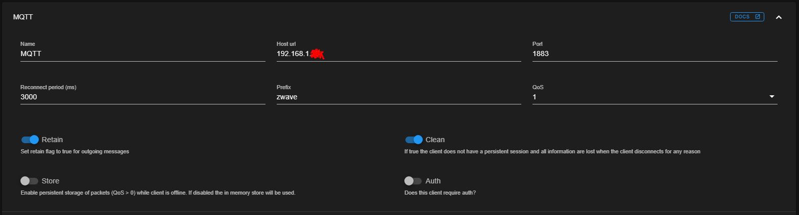

I've now tried, but cleaning the MQTT broker did not solve the complete problem as the broker stayed completely empty after reactivating zwavejs. (except $SYS and zwavejsAD/status=online after reboot of the complete system)
After enabling and analyzing logs and reading and learning more about MQTT and websockets I've found the missing piece:
Zwavejs-UI was not able to communicate with the MQTT broker but Domoticz were. The reason was that the Port in Zwavejs-UI-Settings-MQTT must be 1883 and not 3000 (that I think was default from installation??) and is the only port mentioned as opened in the zwavejs-UI container defined by the proposed docker-compose.yml file in addition to the web-UI port (which prevented me from suspecting this as an error from the beginning):
ports:
- "8091:8091" # port for web interface
- "3000:3000" # port for Z-Wave JS websocket server
I must have tried to change the port from 3000 to 1883 temporarily while still not having the MQTT-topic different from the Autodiscovery topic, that's the only explanation I have for the "half-filled" MQTT broker shown in the beginning of the thread missing the zwave topic.
Stupid error by me, I admit, but to make the installation process of zwavejs-UI to Domoticz more idiot proof I would suggest that the complete zwavejs-UI MQTT settings were shown in the excellent wiki-page: https://www.domoticz.com/wiki/Zwave-JS-UI like this:
