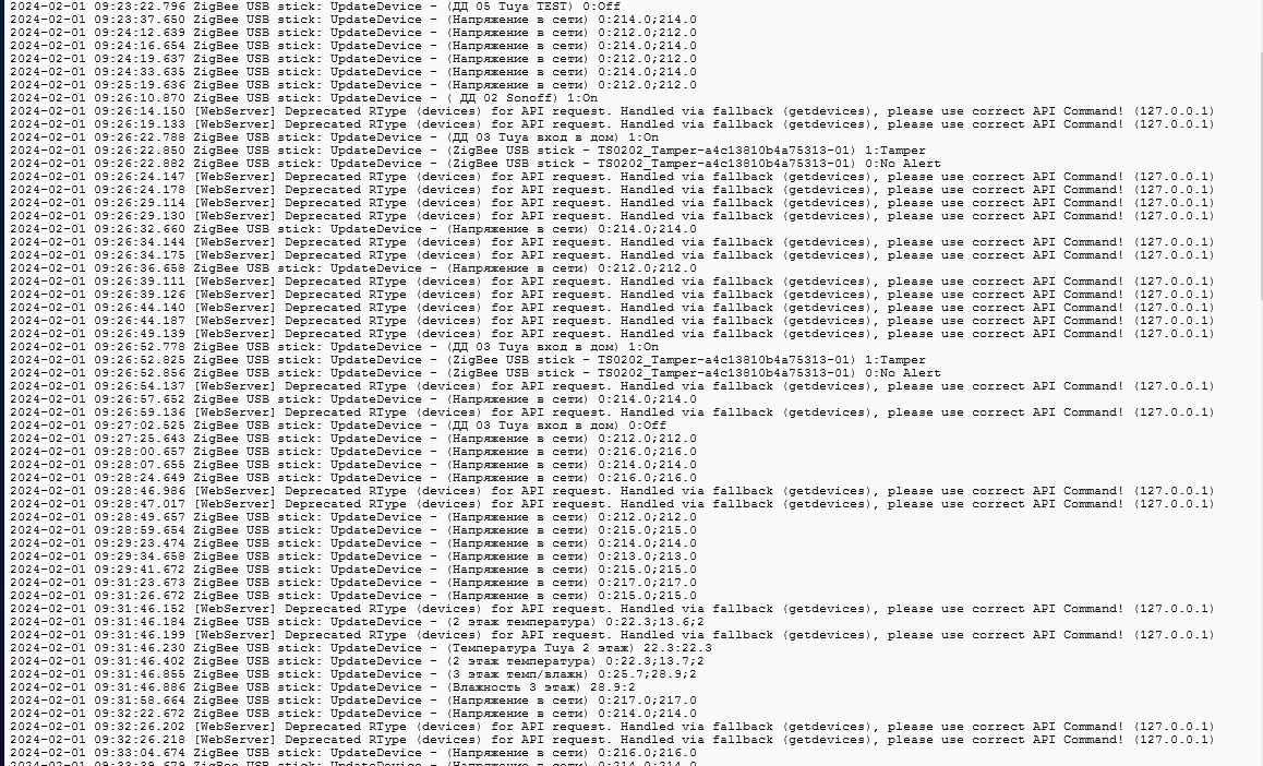

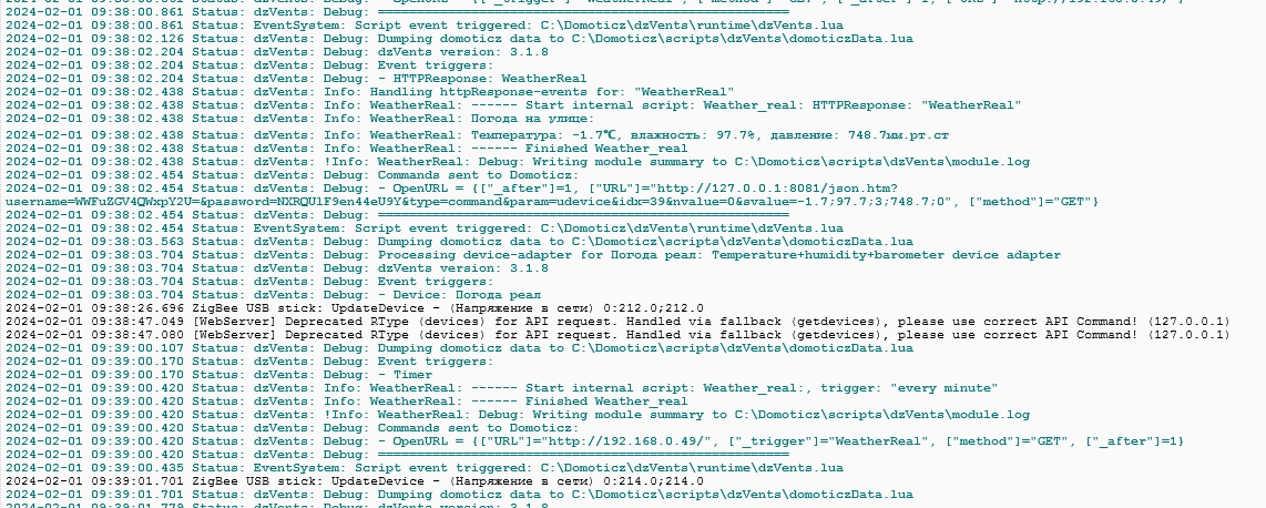

habahabahaba
Posts: 266
Joined: Saturday 18 March 2023 14:44
Domoticz version: 2024.4
Re: Since new Domoticz API syntax - Node-Red --> MQTT --> Domoticz doesn't work
Post by habahabahaba »
Updated from 2022.2 version and see the same messages.
Yes i read that that is not an error but annoying :oops:
How can i find who is sending and what? And will it cause problems in the future?
Debug mode didnt help.
SystemName "windows"
UseUpdate true
build_time "2024-01-30 11:16:34"
dzvents_version "3.1.8"
hash "731719420"
python_version "3.8.2
status "OK"
title "GetVersion"
version "2024.4"
Only Domoticz and ZigbeeForDomoticz plugin
