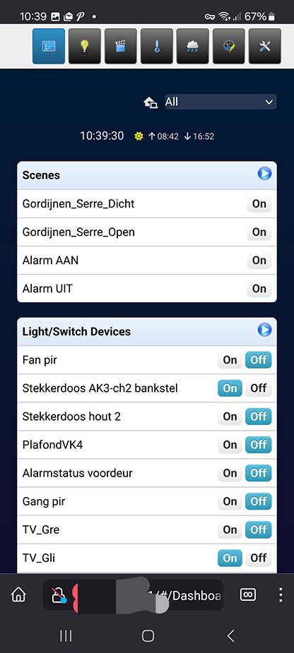

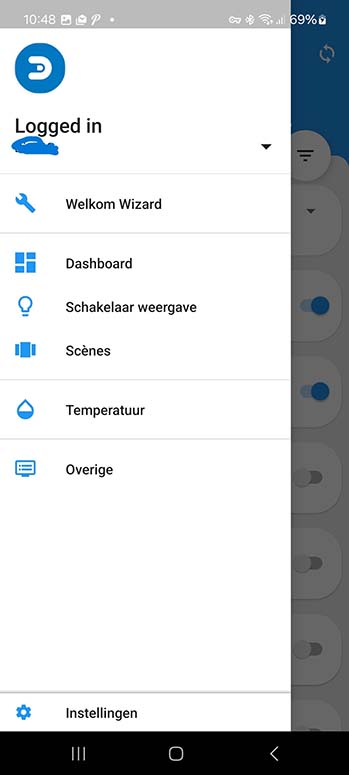

Both my (paid version) app and internet browser, not all tabs show up (or menu options). The app: if I open the menu and i am connected to my local home network I get the app1.jpg attachment view; outside my local network and connected to 5G i get the ap.jpg attachment view. If opening Domoticz using my browser on my Android 14 phone, connected to my local network you see expl2.jpg attachment. Outside local and on 5G I get only the tab Dashboard and Tools. I already cleaned my cache, now it stops for me. Any solution for this problem?

Check the user that logs in. In menu setup - users the tabs per users are being defined.

Thanks a lot, I did not realized that. :D
