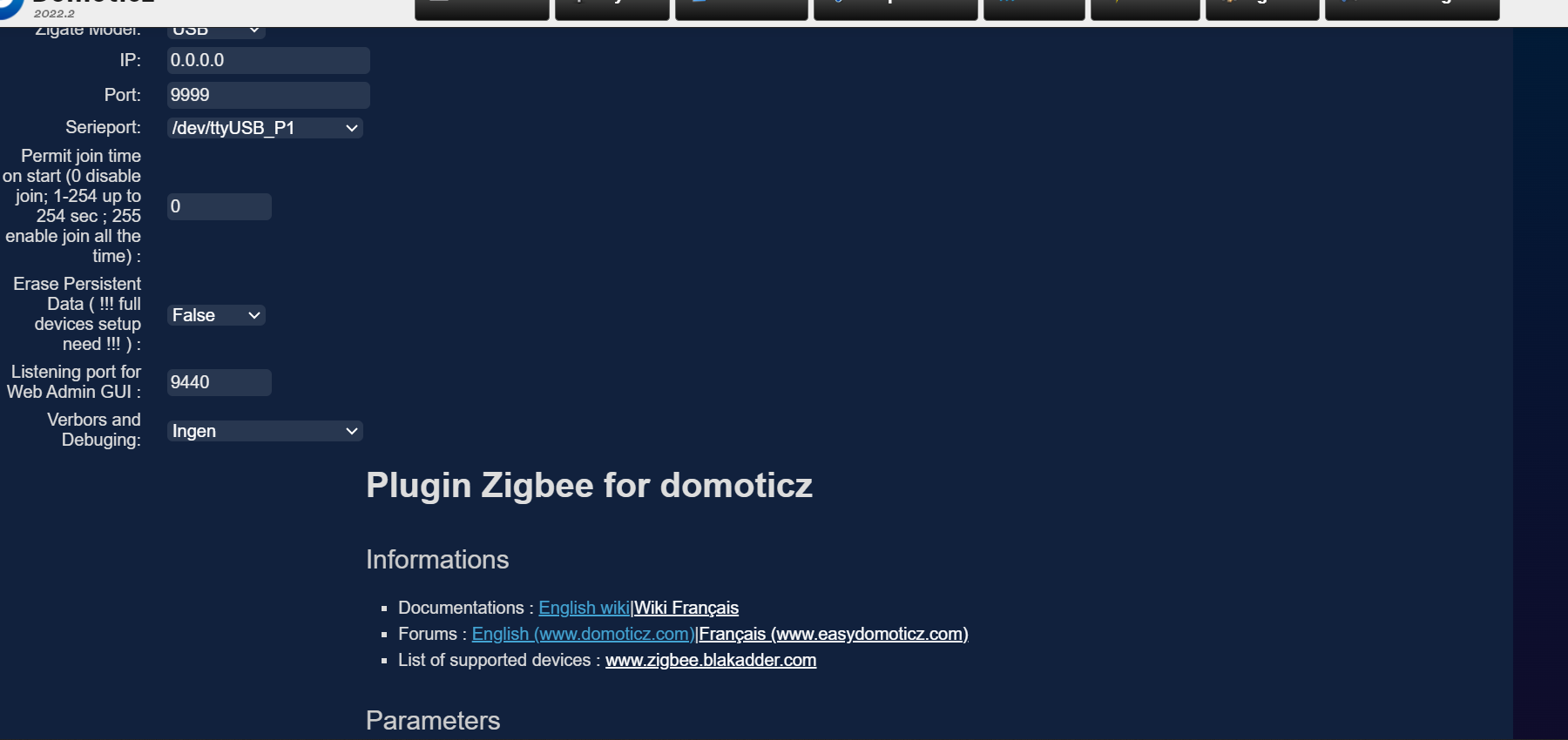

i think i managed to install it now, but do i have to delete the old zigate plugin? as for now i get both the old zigate settings menu and the new zigbee menu at once , even if i just choose the zigbee plugin , there both baked into one , if i delete the zigate plugin, do i then loose all my paired nodes?
i made a screenshot, i could get it all but i hope you understand what i mean.
Skärmbild 2024-01-08 222222.png (121.58 KiB) Viewed 9810 times

Yes, you can have only one plugin code under the plugins folder. So you need to remove one and indeed you'll loose all.
Now I do not really understand what you try to achieve. If you have already one plugin installed and working why do you want to do?
