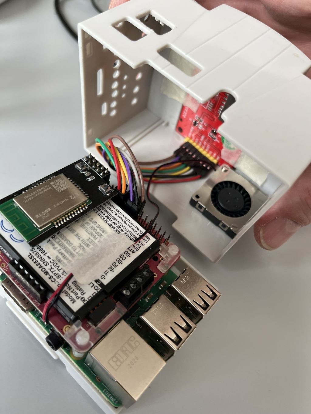

I manage three Home Automation devices based on Rpi3B+ which have the same Hw configuration which obviously control different devices :
[Rpi3B+] [2,2" Status display] [PIiJuice] [Texas Instrument Znp] closed in a 35mm DIN module with fan.
I use BullsEye + Domoicz + Zigate + DGTBoot (Telegram remore Control).
Recently in order to use the latest releases of Zigate I had to upgrade to BullsEye and it had already been complicated to remember everything needed.
So I made myself a disk image where to type different information between the three domotic contoller I save the dB of domoticz, a settings file to direct the telegramm bot, some telegram menu management file that differs between the three applications.
For now I have not yet found a way to "export" and import the configuration of the ZigBee plugin in an easy way as it is given with the Domoticz DB.
I basically copy the whole installation folder.
What ZigBee files should I save for each individual implementation where they are, so that I can BackUp for a possible restore ?
ps. As of today 6 January 2024 BookWorm 32 bit on RPi3 is not manageable by VNC and therefore I am not upgrading to that system, the 64bit version of the same OS does not enjoy adequate sockets to manage the telegramm bot.
Thank you Andrea.
Mine Din Rail Controlle

Hello, what are you using for the 2,2" Status display ?
iw2fag
Joined: Sunday 19 February 2023 15:54
Re: ZigbeeForDomoticz
Post by iw2fag »
Thorgal789 wrote: Sunday 07 January 2024 9:41 Hello, what are you using for the 2,2" Status display ?
I have a script in python that manages the monitor by accessing system information, captures data from domoticz, checks that the battery is never more than 80% charged.
I check a few parameters.
The monitor is connected via Spi on the GPIOs.
There was a usage trace in adafruit com that I no longer see.
If you are interested I can attach what I had retrieved some time ago.

Woaw, seriously, now I m seing the hardware inside, I see better the work you have done.
Realy impressive, and it's realy "professionnal" result
