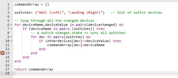

@psubiaco
Finally got around to trying the script you kindly wrote for me, have edited the switch names but I have an error I don't understand, there is an X against a line in the script (see image) but the Domoticz log mentions a different line no. 2024-01-09 08:06:26.951 Error: EventSystem: in Script #2: [string "commandArray = {} ..."]:7: ')' expected near 'in'
I have tried some online Lua editors and they report the same as the Domoticz log but as I see it the bracket number are correct.
Any help would be great

Sorry, it's never a good idea to send code without trying it.
This is the corrected code (but I never tried it, so maybe it has some mistakes).
switches= { "SwitchName1", "SwitchName2", "SwitchName3" } -- list of switch devices
-- loop through all the changed devices
for deviceName,deviceValue in pairs(devicechanged) do
if (deviceName in pairs(switches)) then
-- a switch changes state => sync all switches
for k,dev in pairs(switches) do
if (otherdevices[dev]~=deviceValue) then
commandArray[dev]=deviceValue
return commandArrayPaolo
