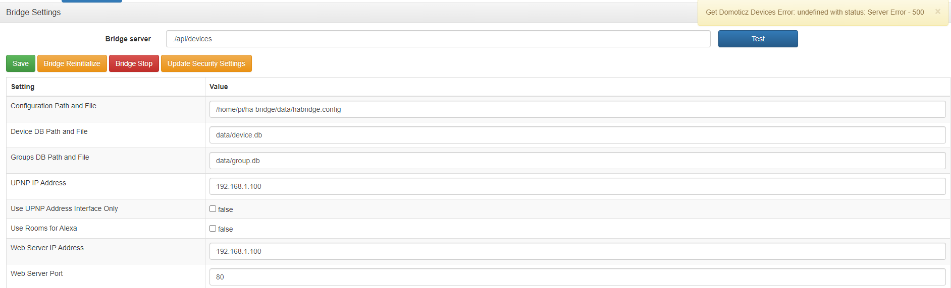

I installed and configured Ha-bridge, but when I go to "domoticz devices" on Ha -bridge, I have "Get Domoticz Device Error: undefined with status: Server Error 500".
My domoticz and Ha bridge use the same Raspberry with 192.168.1.100 IP adress.
Port for Domoticz 8080 and port for ha bridge 80
Configuration in Ha-bridge

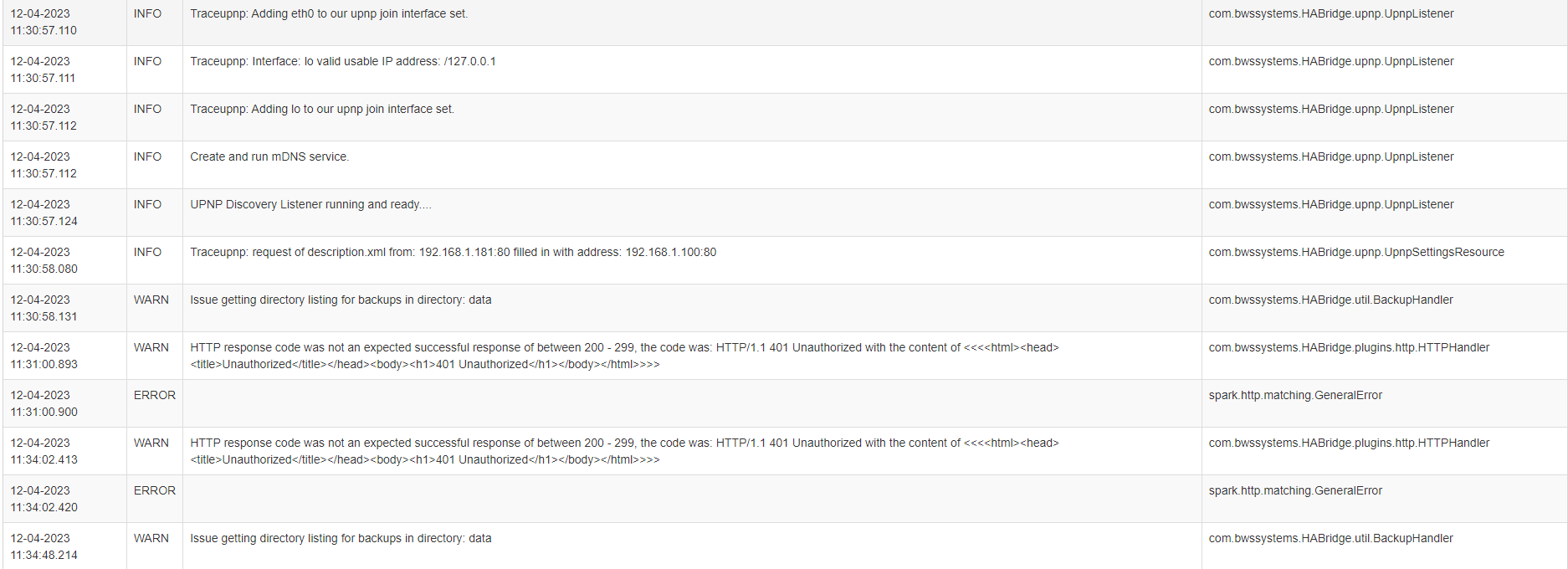

Ha Bridge Log file
Do you have any ideas on what I missed?

YES,
I disabled API Protection and it's work.
