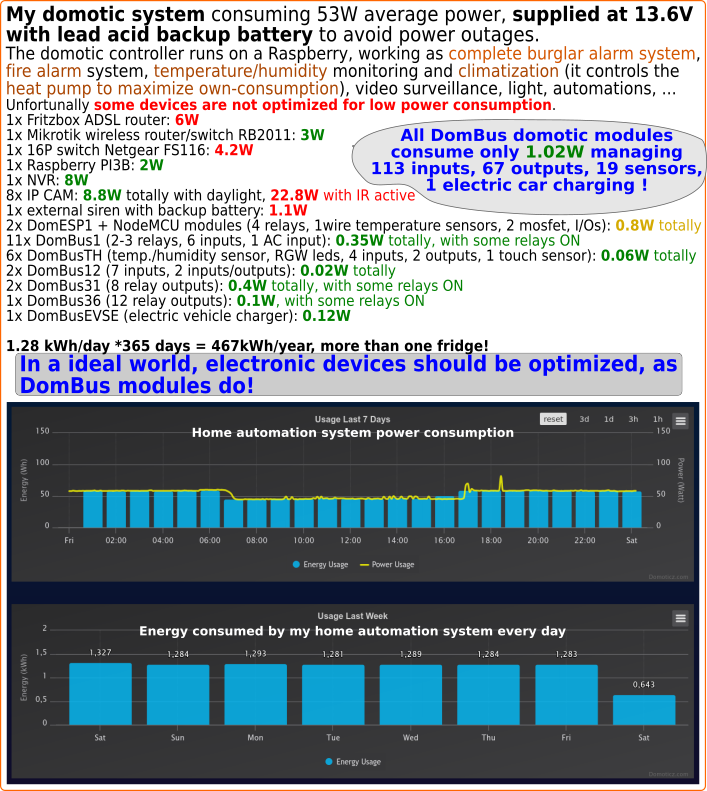

The following picture shows the components used to make my home automation system with Domoticz, using some LUA scripts to manage a complete burglar alarm system, fire alarm, heat pump controlling, light automation, ...
My concern is on the power consumption of power consumption: on one hand I have 23 domotic modules (more than 100 inputs, 67 outputs, 19 sensors) that consumes, totally, only 1W. On the other hand I have stupid electronic devices like a 16P switch consuming more than 4W, a fritzbox router consuming 6W, ...
In my case I'm using DomBus modules, supplied by 13.6V source with lead-acid backup battery, so it can work for several hours in case of power outage. DomBus modules are connected with a thin 4 wire alarm cable, that carry both power supply and data; each module have its own DC/DC voltage regulator to minimize power consumption.
I also have 2 NodeMCU modules connected to some DS18B20 temperature sensors, but I don't like it: ESP8266 consumes about 0.4W with WiFi always ON.
