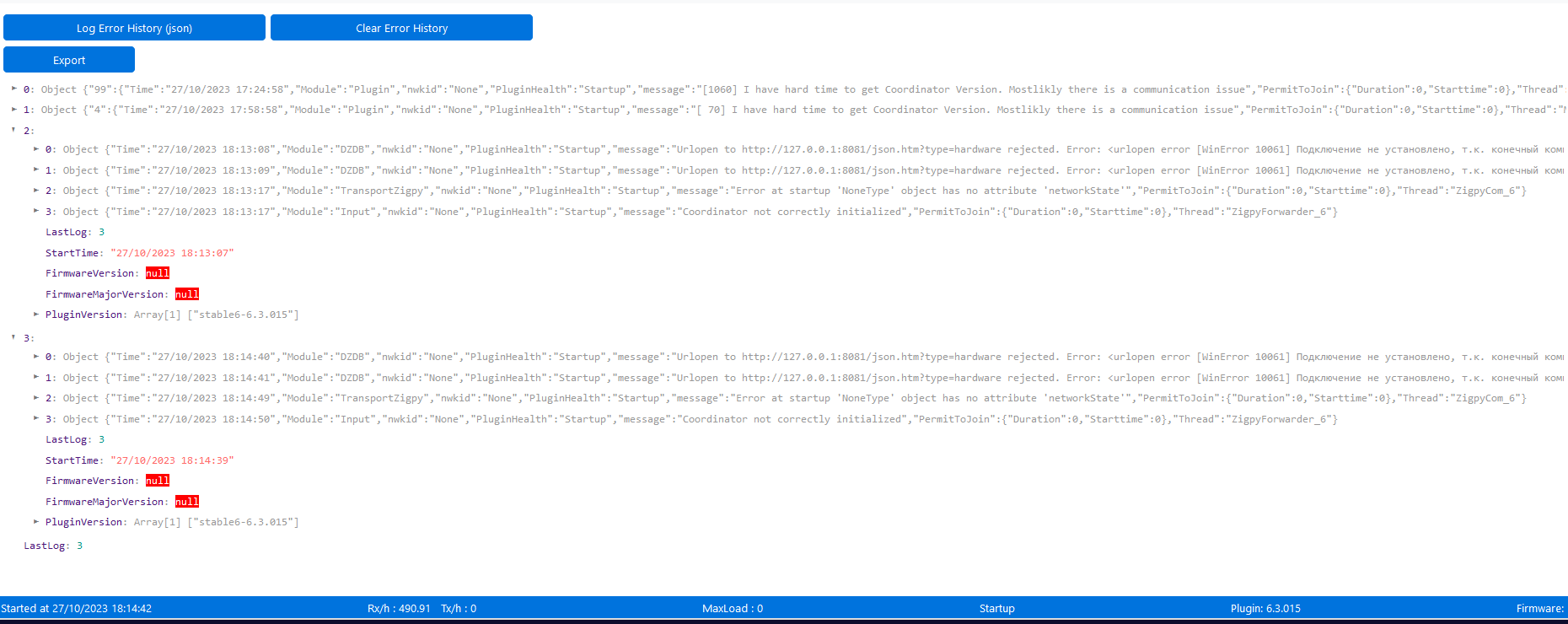

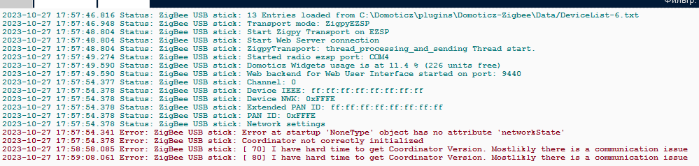

Errors are:
- Error at startup 'NoneType' object has no attribute 'networkState'
- Coordinator not correctly initialized
Wrong chip for Z2M?
Any ideas ?
