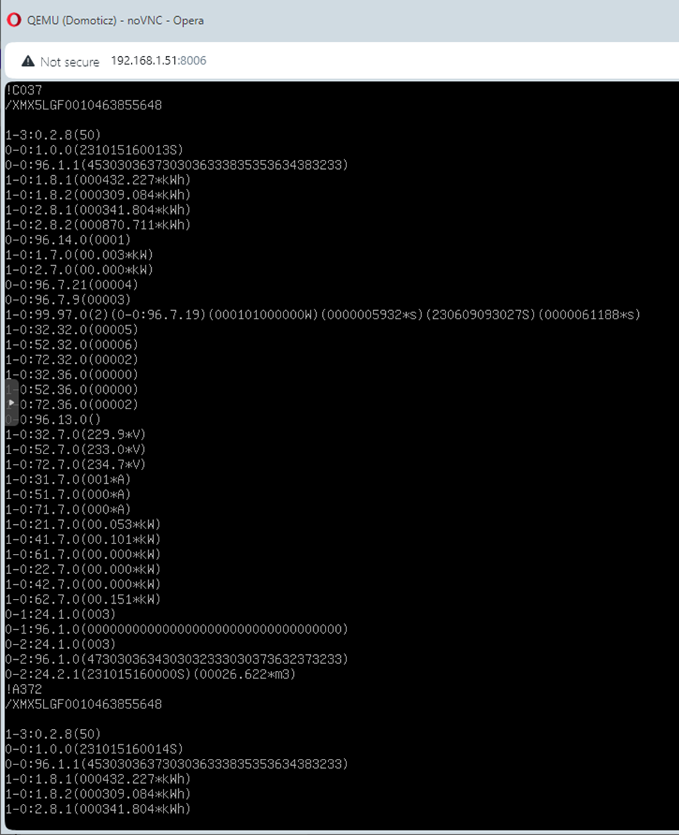

Re: P1 meter USB, all data except gas
Hello again.
This is what I logged, with screen command.
I do not know what to look for. Sorry for that.
Another question, how to post the log file as text?
I get message about posting ",".
24.2.1 is very like gas.
Your smart meter reports two gas meters, the first of which is invalid. Follow the wiki to override the M-bus channel autoselect and set it to #2
- FireWizard
- Posts: 1975
- Location: Voorthuizen (NL)
Hello @Hoofdprutser,
I see that M-Bus channel 1 has been used previously for a gasmeter.
Probably you got a new one and the installer forgot to release M-Bus channel 1.
Your current gasmeter has been connected to M-Bus channel 2.
See 0-2:24:2:1.
Go to the page, mentioned by @HvdW and carry out the configuration described in the last chapter.
See: https://www.domoticz.com/wiki/Dutch_DSM ... th_P1_port (Gasmeter not reporting any data).
Hello all,
Here an update: Succes.
With the override set on 2 it works, but I had to wait for 3 or 4 minutes before it popped up.
As I mentioned before, I tried the override before, but probably not long enough. I waited maybe a minute.
The confirmation of channel “2” helped a lot.
Thanks everybody.
