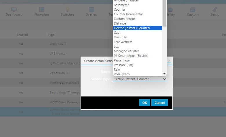

in my case i have a error.
i create this dummy for the picture.
Error: EventSystem: in KW monitor: [string "return ..."]:13: attempt to index a nil value (global 'domoticz')
Posts: 5853
Domoticz version: 2024.7
Re: combine power to single sensor
You have to create a dummy device type "Usage (Electric)". Not a counter or electric instant and counter.

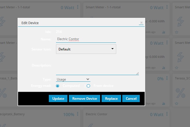

local L1 = dz.devices(178).actualWatt
local L2 = dz.devices(175).actualWatt
local L3 = dz.devices(172).actualWatt
local combinedUsage = dz.devices(214)
local totpower = ( L1 + L2 + L3 )
combinedUsage.update(0,totpower)
dz.log('# totaal vermogen = '..totpower..'')
i just replace my idx. i creata that dummy Usage(electric). No error now, but no results .

This script will count the actual Watt that the solar panels are creating at the moment. So if the solar panels are not working the value will be 0

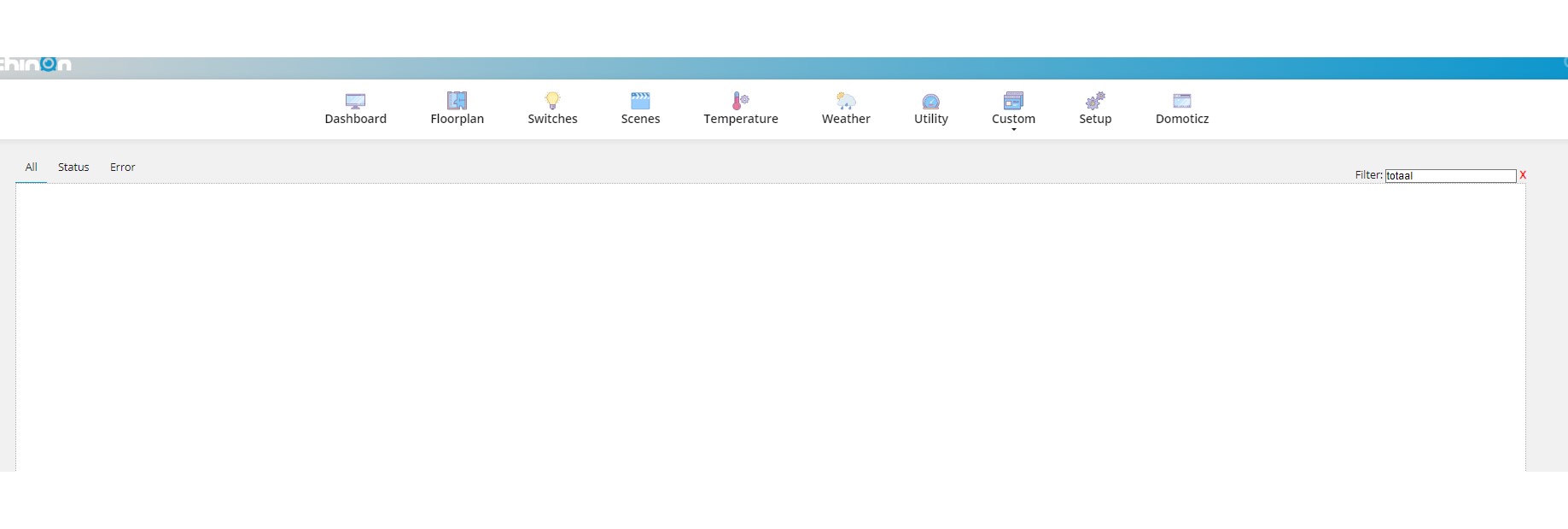

That should also work, what is the log telling you? Go to the log page and typ in the right top corner totaal
(that is stil in you're script)

the dummy is time out :D
no error in log.
nothing if i write in search box :totaal
if i make any modification in the sript, in the log apear this :
