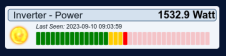

I love the Home Assistant gauge meters that shows the current power, temperature, humidity with a nice widget.
But I also love how the Domoticz reliability, even when several hundreds of devices are connected to it.
I believe that it will be nice to configure some devices in Domoticz to enable a bar widget, specifying:
* min value
* max value
* 2 or more ranges with associated color (usually green, yellow, red)
I've taken a snapshot and drawn some types of bar indicators, just to explain.
What do you think about? I know that it's easy to explain an idea, it's much much more difficult to implement it.
Thanks a lot.

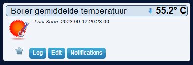

I made a crude form of bar indicator, No fancy colors, just text-based:
I made this to let people see the capacity of heat that is potentialy in the storagebuffer of my house.(if i would show them te actual numbers they have no clue..
The thin line is to display between 24 and 59 degrees, then the thicker line is to display 60 to 75 degrees.
(the value being the same at '53' is just a coincidence...)
It functions ok, only when the value changes the text-device is updated to minimize filling the log with old texts.
Once in a while i have to manualy clear the log because this is not possible to automatically by Domoticz..
Log is now cleared automatically.

Your is a niceand tricky workaround, but the idea is to have, in your case, a normal temperature device within the bar: in this case if you click on the device you can see the chart with values of the last day, week, month, years.RonkA wrote: Tuesday 12 September 2023 13:31 I made a crude form of bar indicator, No fancy colors, just text-based:

You know that temperature icons already change color based on the temperature, blue for very cold, green for cold, yellow for warm, red for hot...psubiaco wrote: Tuesday 12 September 2023 17:44Your is a niceand tricky workaround, but the idea is to have, in your case, a normal temperature device within the bar: in this case if you click on the device you can see the chart with values of the last day, week, month, years.RonkA wrote: Tuesday 12 September 2023 13:31 I made a crude form of bar indicator, No fancy colors, just text-based:

You Sir are correct!waltervl wrote: Tuesday 12 September 2023 19:25
You know that temperature icons already change color based on the temperature, blue for very cold, green for cold, yellow for warm, red for hot...![]()
The thing is that the colors are fixed to preset temperatures, for example:
The buffer i use is stone cold at 24 degrees;
I cannot extract any useful temperature out of it, at this temperature the icon is yellow but should be blue(or green) to be correct for this instance..
This would be nice to possible have this adjusted but it will not be done soon looking at:
https://github.com/domoticz/domoticz/issues/5718
Oh i can see all these values in the device which is used for te data to make the text: What you are suggesting would be much easier and a hole lot prettier on the eyes and would be greatly appreciated but alas it is not 'yet' possible to have this in Domoticz. Maybe in the future?psubiaco wrote: Tuesday 12 September 2023 17:44

I like the "Inverter - Power" one the most...
