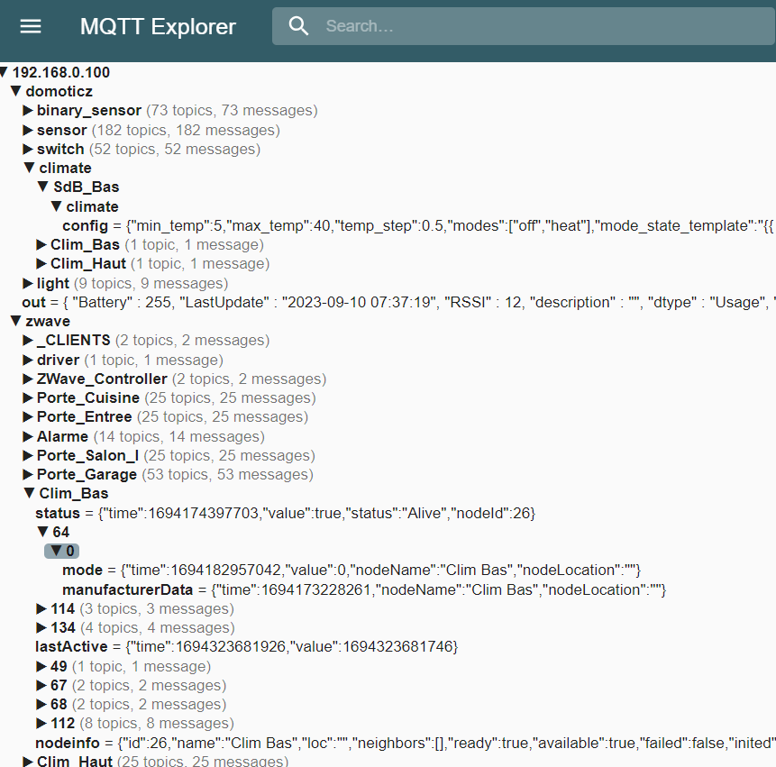

Re: No device listed under "Setup" on MQTT Auto Discovery
Post by woddou »
There is no subtopic called number in any of the devices, is that normal ?
By the way my prefix on both Domoticz qnd ZWaveJS is domoticz.
MQTT Explorer screenshot.png (36.45 KiB) Viewed 13905 times

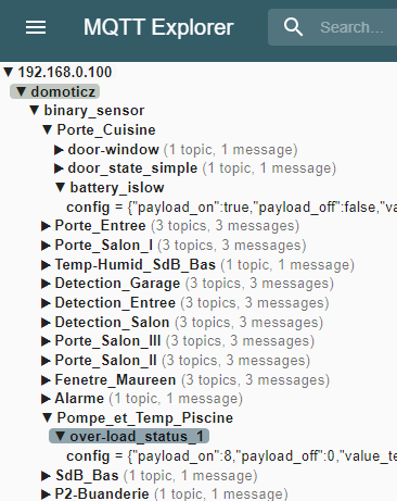

Unfolding here is what I have, no "number" device as per say
MQTT Explorer screenshot 3.png (99.71 KiB) Viewed 13867 times
Quite wierd that not a sngle device among the ones I have from different brands is not publishing any configuration. Is it due to a specific setup on ZwaveJS ?

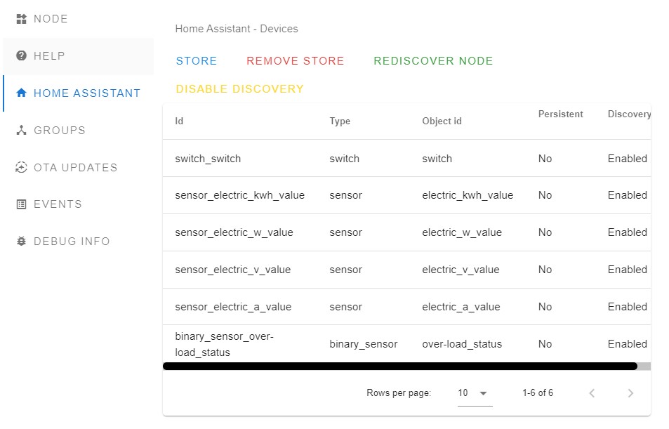

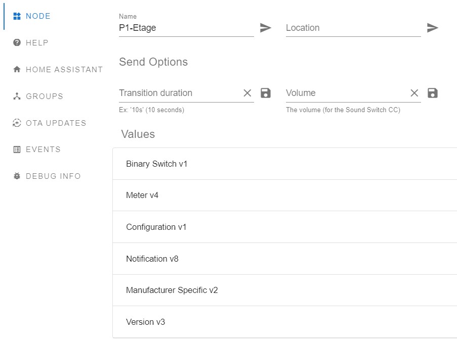

Digging a bit more...
Here is the difference for one device on ZwaveJS UI Control Panel.
Under "Node":
ZwaveJS UI Node.jpg (47.77 KiB) Viewed 13799 times
Under "Home Assistant":
ZwaveJS UI Home Assistant.jpg (68.25 KiB) Viewed 13799 times
So all configuration entities are missing in "Home Assistant" so no surprise that the corresponding topics are not present when I look on MQTT Explorer, therefore no way for the MQTT AD to see this configuration and list them under "Configuration".
Now the question is why these node configuration entities are present under "Node" and not under "Home Assistant" on control panel. For sure this is the same for every single device.
Could you please check on your system and let me know if you have the same or if these node configuration are present on both menu.
i'm still suspecting ZwaveJS UI configuration issue, so if you can share your MQQT, Gateway and Hom Assitant settings that will help me to compare and figure out if it is coming from configuration.
Thanks.
