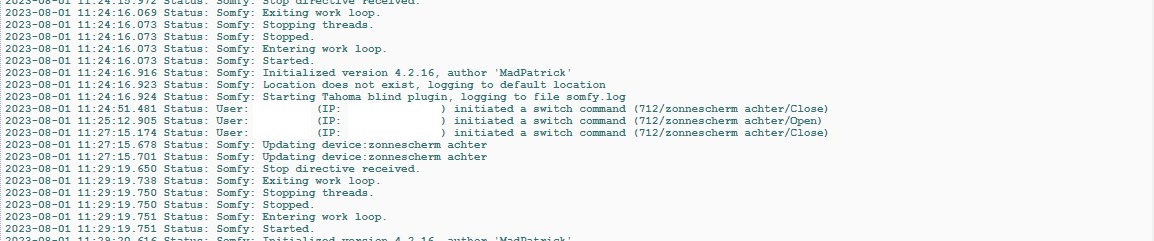

I am using 6 Somfy IO devices, 3 RollerShutter, 2 ExtoriorScreen and 1 Awning. These devices are controlled by a handheld remote, Tahoma box with app on mobile phone and Domoticz with Somfy plugin. The 3 Roller Shutter and 2 Extorior Screens are working fine, every command is executed and status is updated in Tahoma box and Domoticz. Only the Awning has a problem, the commands are executed but as the device has finished the status in Domoticz is not updated (it is in Tahoma box). I have deleted this device in Domoticz and Tahoma box and add it again, same problem. I am using a Raspberry 3B with Bullseye 32 bit and Domoticz 20232. I've had the same problem with Buster and earlier versions of Domoticz. I can't find a problem, are there more users with this problem and is there a solution? Attatched is a Somfy and Domoticz log.

- somfy_Scherm_achter_klein.log
- (361.28 KiB) Downloaded 80 times
- Domoticz_log_Awning.jpg (95.8 KiB) Viewed 2654 times

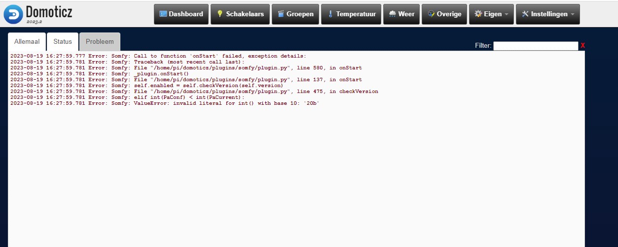

I updated the beta and switched to it. The plugin is now starting but in the Domoticz log i see some problems and the devices are not working...

I have tried some modifications in the beta plugin.py file, if i remove the b in the version number in line 8, so 4.2.20b into 4.2.20 the plugin is starting and i can control the blinds. However every 20 seconds the 2 exterior screens have a status update, even when they are not moving. I think there is still an issue with the plugin, i have too little knowlegde of the software to see what is where going wrong. Hopefully you can find the problem.
Thanks for your help and time you spent on this.

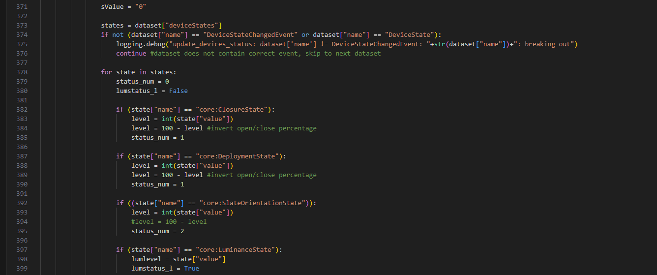

I have made some changes in plugin.py version 4.2.20d. First i removed in line 8 the d in Version="4.2.20d" The plugin is starting now (workaround). I also added line 389, this stopped the continious updating of the 2 exterior screens.
I discovered an other problem with the awning, When giving the command "out" the awning is going out and the status is updating. When finished the status was ok. After the command "In" the awning was moving in, after the first update the updates stopt, there was an error in the Somfy app on my mobile phone and couldn't control the awning with the Somfy app. At this moment the awning was "in". After a second "In" command with the Domoticz there was a status update and the error was gone.
- Modified_4_2_20d.png (61.84 KiB) Viewed 2447 times

Can you post your change as text with code brackets.
That make is readable and i can copy your changes

Find the main change in the attatched text file Wijziging.txt. This change worked for me for the continious updating of the 2 exterior screens. I am not sure that this is the real solution, it is a bit strange but it worked.
This change will not solve the plugin start problem and the awning problem in the Somfy app.
If you like i can test a new version of the plugin.

- madpatrick
- Posts: 885
- Joined: Monday 26 December 2016 12:17
- Domoticz version: 2026.1
Re: Somfy device has no status update in Domoticz
Thanks for sharing.
I cannot test this since i do not have this device.
Change:
if (state["name"] == "core:DeploymentState"):
level = int(state["value"]) #Don't invert awning open/close percentage
status_num = 1
in:
level = 100 - level #invert open/close percentage.
status_num = 1-= HP server GEN11 =- ZwaveJS-=- Domoticz v2026.2 -=- Dashticz =-
