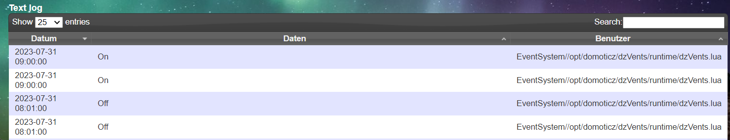

Hi there,
i have a specific device which is switched on (and of) via dzVents events (timer event based). Everything is fine with that.
I recognized, that in the device log all on/off events occur twice/doubled, caused by the event system. Which might be the cause for that?
dzVents-Script:
domoticz .devices("TestSwitch").switchOn().forMin(1)

Hmm, i recognized that this also happens when manually switching the device, so it might be an issue with the device itself?
