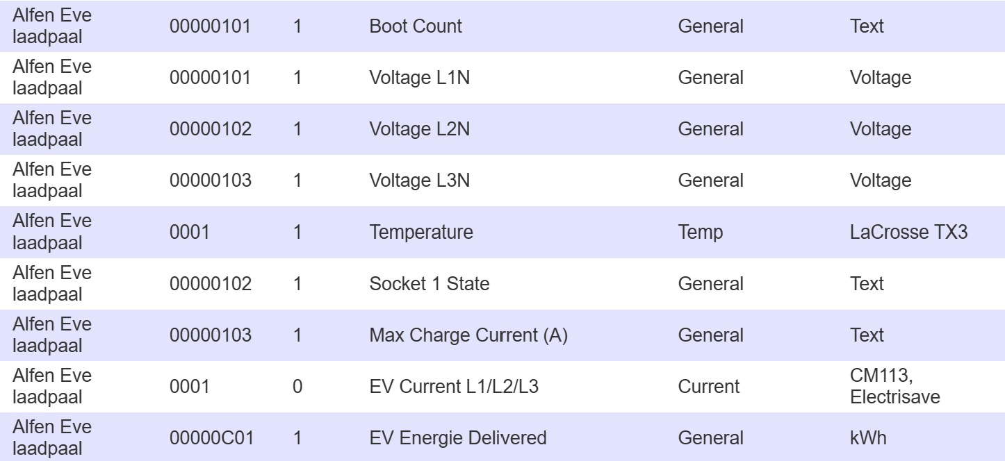

And for anyone wondering what this hardware does:
It will create 9 devices as show below, of which I think the EV current and EV energie delivered are the most useful, especially if the car only shows km or % and not kWh. So you can track how much energy actually goes in.
Once my car is delivered ..... I plan to use the Alfen Even software in combination with the Hyundai or Kia car interface software on below link to track energie delivered/stored/used and mileage of the car.

willemd
Posts: 735
Domoticz version: 2024.1
Re: documentation Alfen Eve charger ?
Post by willemd »
Yes, Alfen can handle only one single login active at the time, so for the Domoticz interface to work you have to log out of the MyEve or ACE installer app.
If no devices are created, did you see my solution above by not using a password that requires uuencoding? Although that should have been fixed.

willemd
Posts: 735
Post by willemd »
athoopen wrote: Sunday 01 February 2026 11:34 My password is made out of chars (up an lower) numbers and one really famous strange character LOL. I don't think it's in there. Next to that it does report the version number. I assume it needs to login to get that version.
I a saw that my charger is on a (very) old version 6.6.2 something, currently version is 7.2 or something close to that. Likewise, I will first get my charger up to date, after that I will retry if I can get this to work.
Thanks for the support sofar !!
Your assumption is incorrect. It will report the firmware version even if the login fails. See above.
Also the firmware version does not matter. Mine runs happily on 6.3.0.
