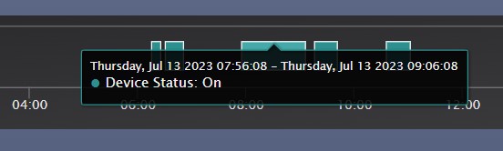

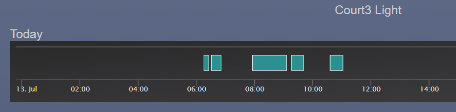

2. Dzvents looks at lux level and determines whether light is on or off and updates a virtual light switch (pic examples attached)

all working ok , but how do I work out utilisation for a specific time period ?

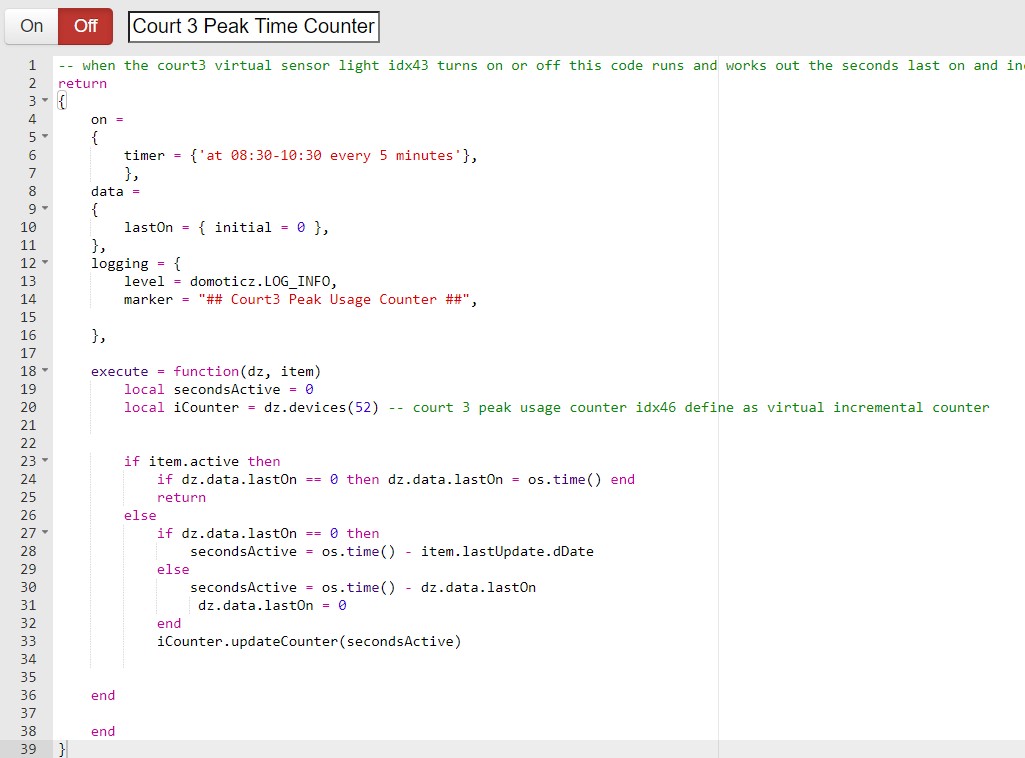

current incremental counter is below
assume I will need a trigger similar to this ?
timer = {'at 17:00-19:00 every 5 minutes'},
can you provide an example of how I zero everyday at start of peak time and how I then trigger a calculation at the end of the peak time ?
I tried to post the dzvent script this was not allowed, added a pic instead, is this due to me being a newcomer ?

at the moment I have this as a trigger
on =
devices =
43, -- court 3 light idx43 device for which you want to record the On time.
will change to this
on =
timer = {'at 17:05-18:55 every 5 minutes',
'at 17:00',
'at 19:00',
identify which timer triggered the event with this: ?
if timer.trigger == 'at 17:00' then
-- setup for initial use
elseif timer.trigger == 'at 19:00' then
-- finalise and calculate
is somebody able to explain the 3 code steps here please ?
if item.active then
if dz.data.lastOn == 0 then dz.data.lastOn = os.time() end
return
secondsActive = os.time() - item.lastUpdate.dDate
secondsActive = os.time() - dz.data.lastOn
dz.data.lastOn = 0
regards phillip
on =
devices =
will change to this
on =
'at 17:00',
'at 19:00',
if item.active then
return
dz.data.lastOn = 0
regards phillip
willemd
- Posts: 740
- Domoticz version: 2024.1
Re: How do I Calculate Seconds ON for a device between 5pm and 7pm daily?
You will have to write the code yourself , here is the logic.
I think you could also use domoticz.devices(yourIDXnr).lastUpdate.secondsAgo
So:
1) reset a counter device to zero at 17:00.
If the light is already on at 17:00, make sure to record the number of seconds since it was switched on (in a persistent variable for example) so you can subtract that later.
2) Every time the light changes from on to off, determine secondsago and add to counter device.
If the light was already on at 17:00 make sure to subtract the number of seconds of the persistent variable, otherwise the seconds before 17:00 are also counted. But only do this during the first update (if you set the persistent variable to 0 after first use, then this is solved automatically)
3) at 19:00, if the light is still on, add the seconds to the counter device otherwise don't update the counter
and then divide the total of the counter device (=seconds on during the two hours) by 7200, multiply by 100, and then you have the percentage.
So:
