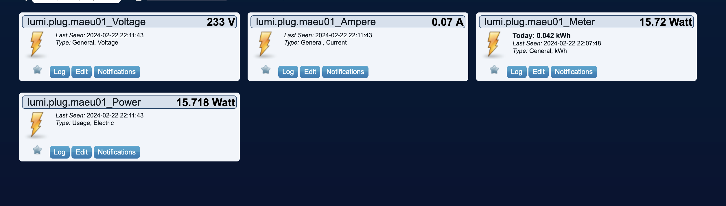

Hi just pushed an update of the config file [4.224] which would required to on a specific plugin branch until I release it
you can simply do :
Unfortunatly you'll have to redo a pairing and remove the existing widget created.(removing the plug from Domoticz and the plugin)
You'll get the following widget information on top of the Switch On/off
you can simply do :
git pull
git checkout wip-stable7.1.009
sudo python3 -m pip install -r requirements.txt --upgrade

Re: Zigate - Aqara Smart Plug power measurement problem
Dear pipiche,
Thank you! I just did everything you mentioned in your post. I tried it on my test-system. And now I can switch on/off, read the power and also read the voltage and current. Great job!
I’ll wait until the next release for installing this in my “production” domoticz system. Thanks!
