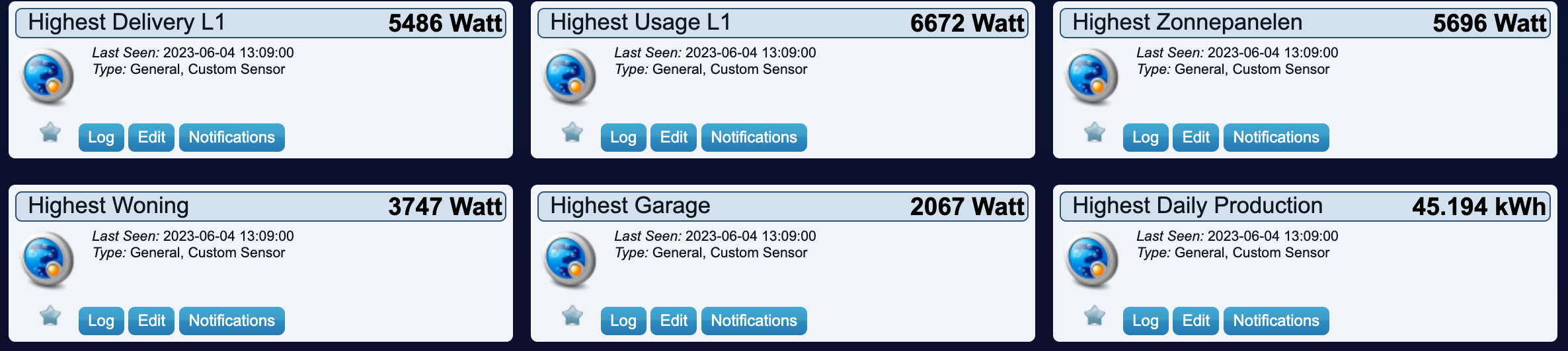

I've made some scripts to log the maximum values of what my solar panels produced (per system, I have 2 inverters), what the maximum return was until now and what the maximum usage has been.
Could this be built in as an extra feature so no extra Lua / dzVents scripts are needed anymore?
Scherm­afbeelding 2023-06-04 om 13.09.34.png (187.61 KiB) Viewed 793 times

The current reports are not sufficient if you quickly want to see what the highest production so far is. I've managed to make a Lua script for this, but I think other users might like this built in as a feature. So, there is no "need" for it, but it would be a nice addition.
