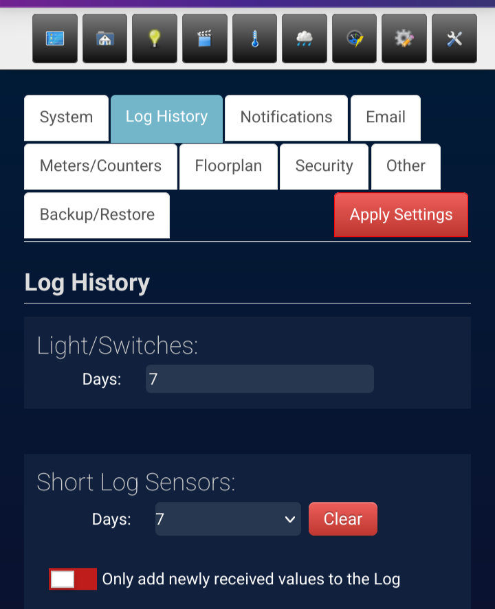

There is an option in the settings (menu setup-settings tab Log History) to update sensors only when new data is received and not updating it every 5 minutes with the old data. It is a setting for all sensors, not only energy.
