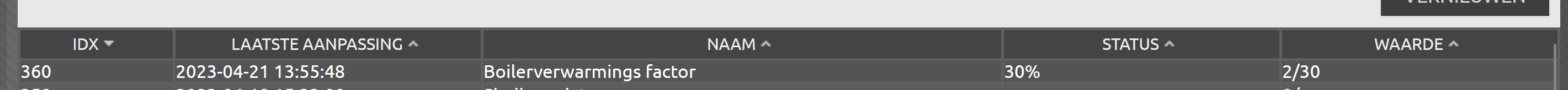

Is there a way to use the value or status of this selector, so I can make the line like
local Kwh = Inverter.actualWatt*'my selector switch'
If I look at the selector status, this is already 30%
If I try to
local Kwh = Inverter.actualWatt*'my selector switch'.value
Then the error is "nil value"
Posts: 6691
Domoticz version: 2025.1
Re: Power percentage increase
you can use the level of the selector
Level 0 : 0%
Level 10: 10%
Level 20: 20%
Level 30: 30%
etc
Max number of levels is 30
You can then use something like below. Depends of 50% means multiply with 0.5 or 1.5
local Kwh = Inverter.actualWatt*(100/domoticz.devices('your selector switch').level)
or
local Kwh = Inverter.actualWatt*(1+(100/domoticz.devices('your selector switch').level))

RonkA wrote: Friday 21 April 2023 18:12 IMHO your goal is to in essence 'add virtual solarpannels', that are powered by mains, to the equation when the yield of your solarpannels is less in the wintertime?
That's correct! During the wintertime I want to add some extra power in to my heating system as electricity is cheaper then gas, I have 2M³ heat storage that I can heat up during the day with my solar system. But as the solar power is increasing I want to change the value that I add from the grid.
Now I can use a selector switch to change the percentage I add from the grid.
Next step might be creating a script that checks the period of the year, average lux and temperature to control the % (I think that will take me some time to figure out :lol: )
For now it seems I got a working script without issues and correct values.
Kwh_n is the actual value of the inverter, than changed the formula to:
local Kwh = Kwh_n*(1+(factor/100))
Full script that seem to work:
