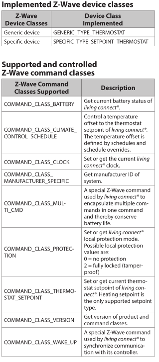

here are the specifications:
- Danfoss-Z-Wave.PNG (102.37 KiB) Viewed 4542 times
