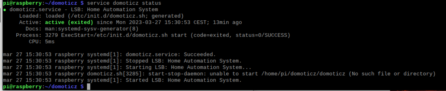

I have installed raspbian bullseye as vm i Proxmox, OS and everything seems to work fine. After installing Domoticz (sudo bash -c "$(curl -sSfL https://install.domoticz.com)") it won't start.
service domoticz status give me pic, but the files are there "/home/pi/domoticz/domoticz"
Domoticz starting failed

- Skärmklipp1.PNG (191.83 KiB) Viewed 571 times

Check the log file if visible (else make it log on drive instead in memory only) see
https://www.domoticz.com/wiki/Troubleshooting
You could also try to run it as a program with command ./domoticz and see what is getting logged.

looks like problem from topic viewtopic.php?p=301917
For the install you probably will have to make sure that your VM is strictly 32bit
Cheers
Al
