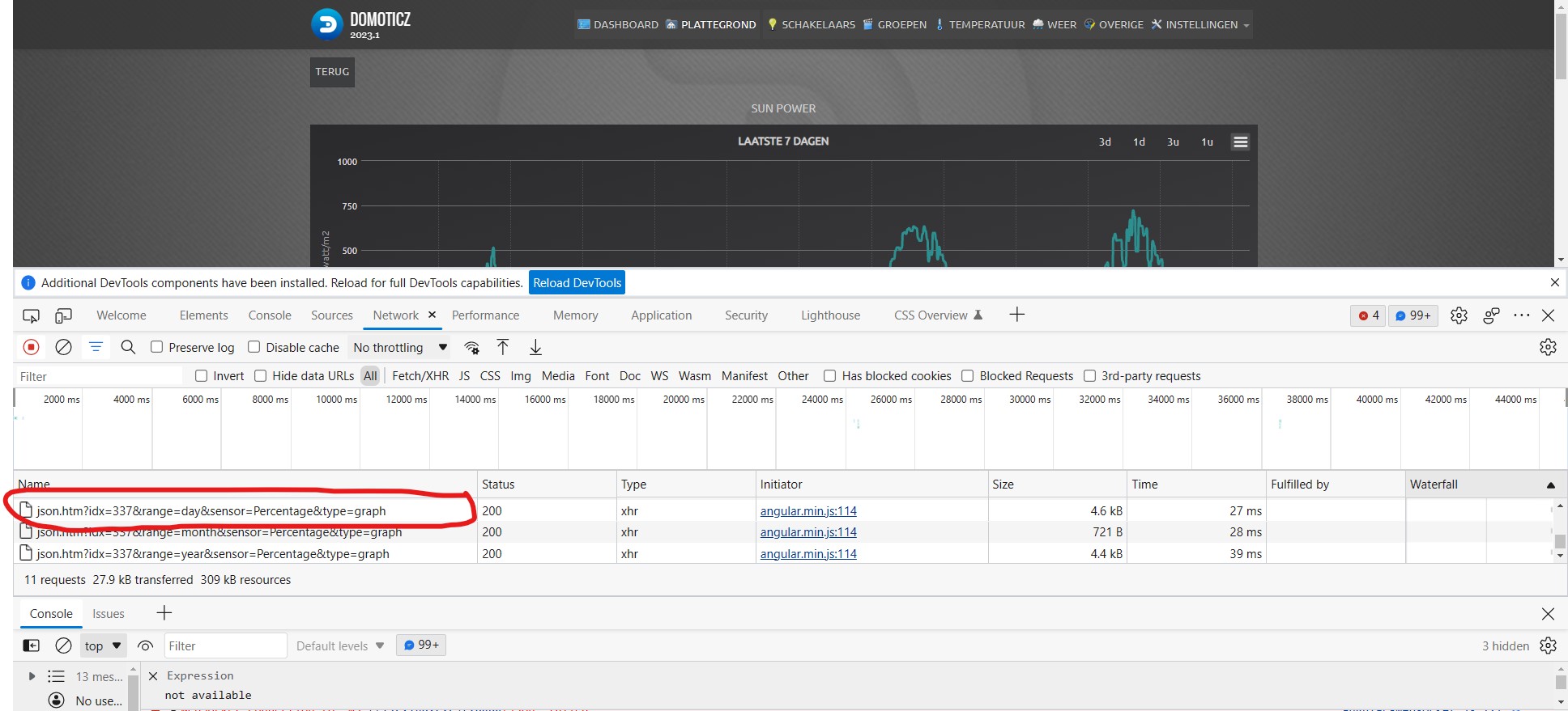

Another option is to use the same API calls the Domoticz webinterface is using in the graphs?
Open the browsers developers console (F12), dock it to the bottom for easier reading.
Select the network tab, now navigate to the device graph
You will see a daily call, you can use this call to retrieve the data

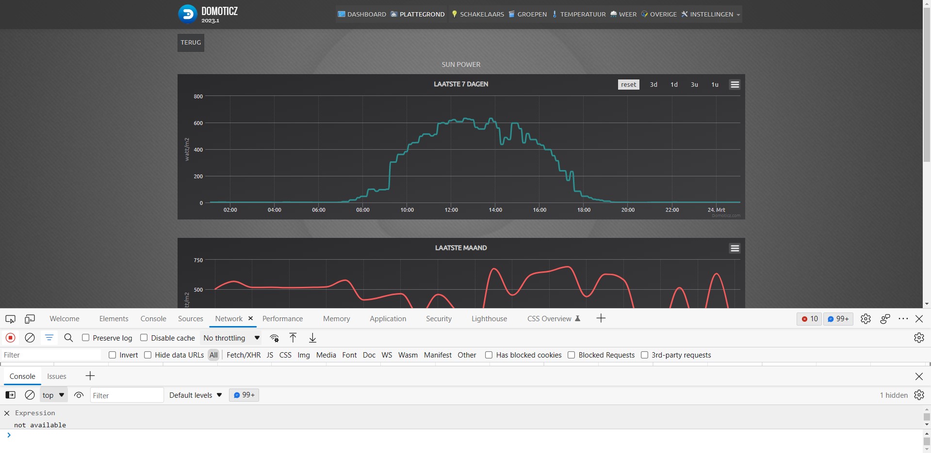

@gizmocuz
I do'nt see anything. What am I doing wrong?
Schermafbeelding 2023-03-24 010746.jpg (223.09 KiB) Viewed 827 times
gizmocuz
Posts: 2712
Location: Top of the world
Re: Domoticz chart2csv
Post by gizmocuz »
This is because there is no room to display, make it higher... and/or close the bottom console with the cross on the right (seen from the bottom)
Then refresh the page, or go to another view, clear the network log (circle with the stripe next to the record button) and navigate back to the log

Then I'm presumably looking for this?

I'm still curious about your alternative solution. Am I on the right track with the picture above?
And how then?
