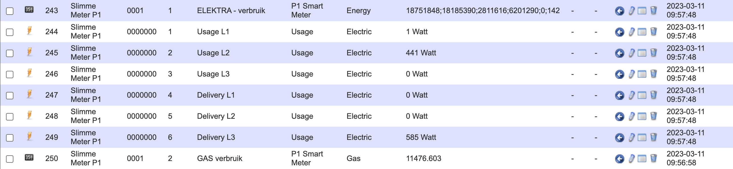

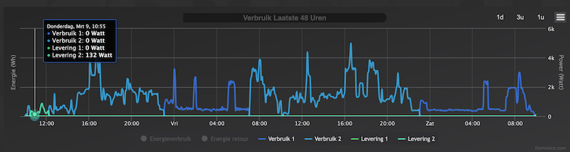

I have the latest version of domotica working, and added new solar panels with a singe fase installation. They feed on L3. Other solar panels feed on 3 fases L1,L2 and L3
In the details I have all fases visible.
But in the overall diagram I am missing fase 3. How do I solve this ?

See the pictures. Levering = Delivery

Hello @pa0esh, Erik,
Don't worry, everything is allright.
You mixed up the consumption for each phase with the tariff (low = tariff 1 and normal = tariff 2).
