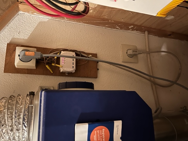

I have done something like this viewtopic.php?p=147088#p147088
I left the perliex plug original and made it switchable with a 3 port rfcom switch. You can of course use a different kind of remote switch like zwave.

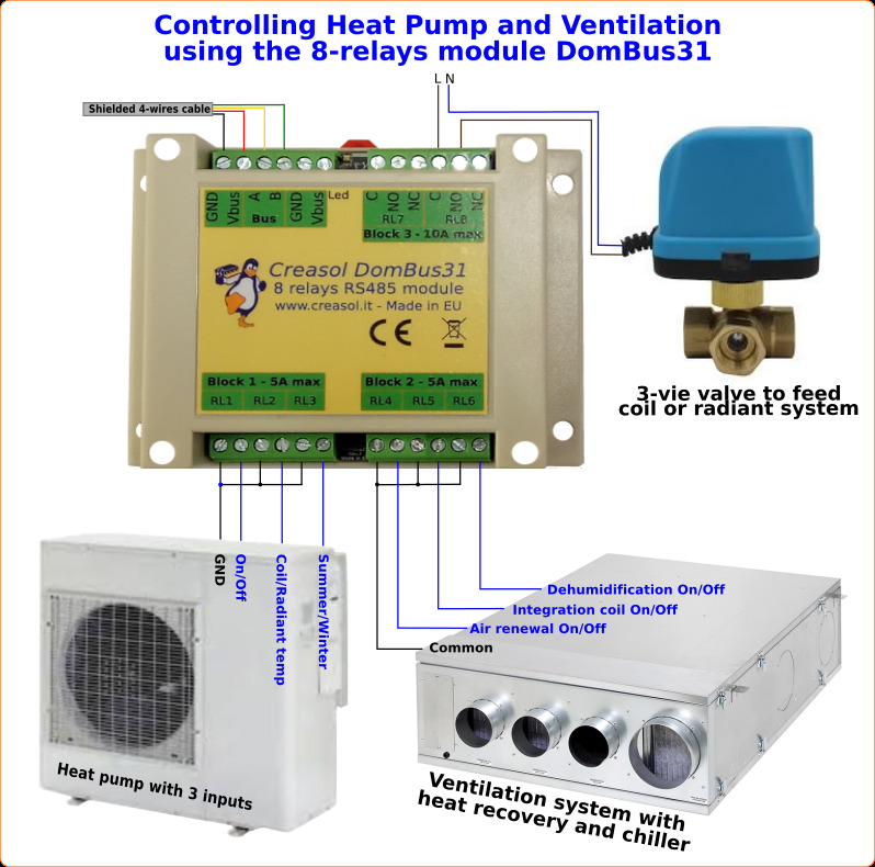

you don't need a ventilation system with WiFi.
My ventilation system ( EMMETI RECUPERADRY ) has a controller with some inputs that can be connected to a domotic relay module, to enable/disable
air renew
Dehumidifer (chiller)
hot/cold water exchanger
Maybe all VMC has such inputs.

I think there’s but they are much expensive then this solution and you have the choice how to controle them by zwave,rf or zigbee,
I have left the original cable in tact from the litho ventilation system see photo

rron wrote: Friday 03 March 2023 12:32 I think there’s but they are much expensive then this solution and you have the choice how to controle them by zwave,rf or zigbee,
I've the same configuration with a fibaro switch 2
Then you can control the ventilator in 3 speeds. : On/low/High
An advantage is a rron says, you can keep the perilex connection to original
