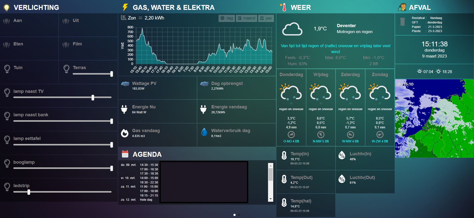

1 : yes indeed, the dots are a little too close together, you can also use the swipe function to swipe to the next screen.
but adjusting de dot distance or the size of the dots would be usefull
2 : i don't use the top main bar, i use time, date and temp as blocks in the rest of the dashboard. i dont think its very usefull to use it in the top because you can't style that tekstform

And you see valuable information to replace the bar with blocks. I also see that you have reduced the spacing between the blocks and there are practically no them at all, which also gives you more space.
Where are these gaps reduced?

To reduce the space between the blocks you can use the following code in custom.css
.transbg[class*="col-xs"] {
    border-width: 1px !important;
