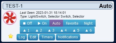

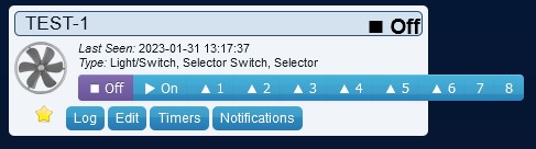

I know how to encode and decode LevelNames but I don't know how to make the names not stick out beyond the outline.
How to put new line in Switch Selector LevelNames when there's more levels?
Switch/Selector How to make new line LevelNames

Re: Switch/Selector How to make new line LevelNames
Use the drop down selector type (through Edit button) as that has been designed to use selector switches with too much levels.
Thank you for your reply. I know what you mean but I've seen some smart guys do it differently.
- Posts: 6684
- Domoticz version: 2025.1
Then we wait for the smart guys....
I did it. Used two times function in file LightsController(.)js file and it's wotking.
Do not be mean xD
The thread can be closed.
if {} else {}Do not be mean xD
Document it as you will loose this change after an update.
