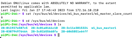

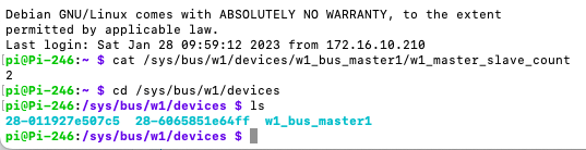

I have overcome the problem of DS18B20 and recognition by last address decimal. I ordered several DS18B20's by different sellers, so I have now 6 sensors that are recognized as separate sensors. Now I have the problem that sensors are dropping out of raspberry. With the command:
cat /sys/bus/w1/devices/w1_bus_master1/w1_master_slave_count
I get the reply how much sensors are detected. After 2-48 hours of hard reset (power off) the reply is always less then 6. Sometimes it is 6 but after some time the sensors are dropping and are not recognized anymore. This means that the directory's are not present.

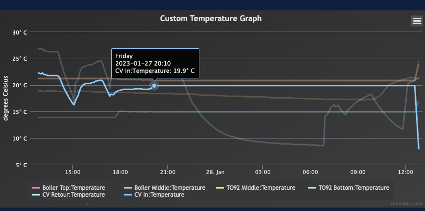

In below graph it shows that sensor stops working on Friday at 20:10 and spikes up after restart raspberry on Saturday at 12:xx
Only CV retour and Boiler Middle kept working over this period
I have read something about counterfeit/fake sensors, but also about a piece of 1wire software that is not working correct in the newest version. Does anyone recognizes this and has found a solution?

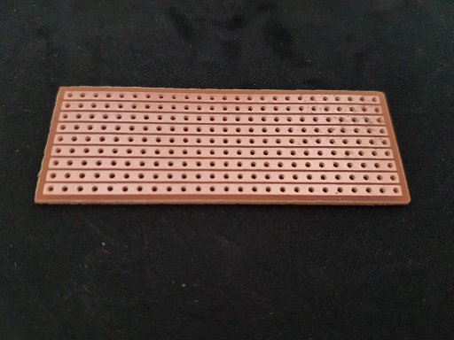

I have all DS18B20 connected to a piece of experiment print and from there i have about 40cm cable to the Pi. The pull-up resistor is also on the experiment board. All the wires from the experiment board are +- 1m long
Strange thing is that the sensors stay working somtimes for 1-2 days and sometimes drop after 1 hour.
To get the sensors back, i have to turn power off/on the raspberry and sometimes 1 or to are missing also and an other power/off/on is needed.
