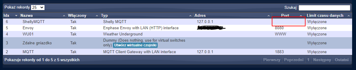

I installed the latest version of Shelly MQTT.
After Shelly MQTT hardware configuration, the Shelly PRO 2PM does not appear on device list.
On the hardware list there is no port number for Shelly MQTT.
"Shelly MQTT" is configured with 127.0.0.1:1883, the same as "MQTT Client Gateway with LAN interface".
What is possible to do with that?

jrachwol wrote: Tuesday 17 January 2023 1:49 What is possible to do with that?
your device is gen2 device. check this topic - 3,4 last messages.
viewtopic.php?p=297821#p297821
