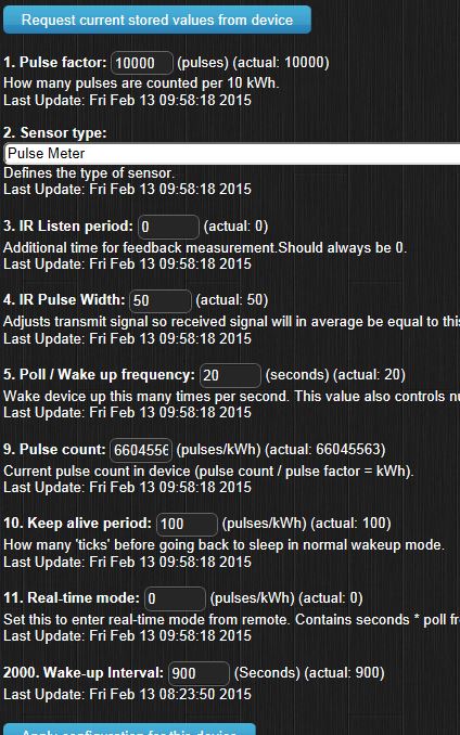

Here's what I found out until now.
1st of all, if you don't configure it to pulse meter, it will not read the pulses. might seem trivial, but somehow it didn't update the reader after resetting it, so double-check that :)
If I press the button I CAN see the led blinking.
It's not possible to set the pulse count to 100.000 (I have a 10.000 imp/kwh and a 1.000 imp/kwh led, wanted to use the 2nd one). I tried eiditing the xml, but not luck so it might be a limit in the em6600.
Yesterday I managed to fiddle around with some settings and everytime I opened the dashboard it would actively request data from the em6600.
Now I have the same situation as yours but it does generate the hourly graphs in devices -> report
Now the thing is.. I have no idea what triggered it to do this..
Yesterday it worked but as the graphs were messed up with my manual input I made screenshot of the settings, remove the node, re-included it and did the exact same settings.. not working..
messed around with some polling and also switched on polling for another device, not it's working again.
The problem now however is it's draining the batteries like crazy.. 3 days, 50% left..

these are my settings
settings
settings
running 2.2025 btw.. I'll check to update tonight to a newer (beta) version

Why is your realtime mode set to 0? Mine had a huge value of 18.000.

the realtime value is (as far as I know) the amount of ticks stored internally so will differ for everyone..'
I made the settings as shown in the pictures, pressed the button on the meter and it started sending data every 15 minutes, which it's still doing.

Update, I had to soft reset my controller so it lost connection.
The trick to get it to work again is have the settings as shown.. I did notice it can take quite some time for the settings actually being stored in the em6600 (pushing the button to wake it up seemed to help a bit).

Well, I think I figured it out..
I moved to a Pi2 and the em6600 wasn't showing new data. Strangely all hardware was ok, except this.
The pulses per kWh and meter type were reset..
Anyway..
To get it to work turn on polling for the em6600, set a proper polling interval in the controller, mine is as 10.
Than set option 10 of the em6600 to 5 (or higher if needed)"
What happens is the em6600 will wake up and stay awake for 5 led pulses, within that time the controller polled the data and there you go..
To get it working the first time press the button on the em6600 once. If it doesnt worh three times.
From than on it should wake every 15 minutes and the controller will pull data.
Should you have a very high power usage or long polling interval you might have to play with the values.
