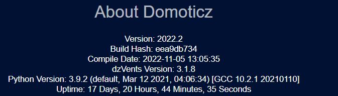

Hi, sorry about missing out the main info:
I am running domoticz on a raspberry pi3B
Thanks for your idea with the linux script.
Can you imagine to work with a script instead (lua/dzvents)?
It will be easier to maintain within the domoticz scripts backup etc.
