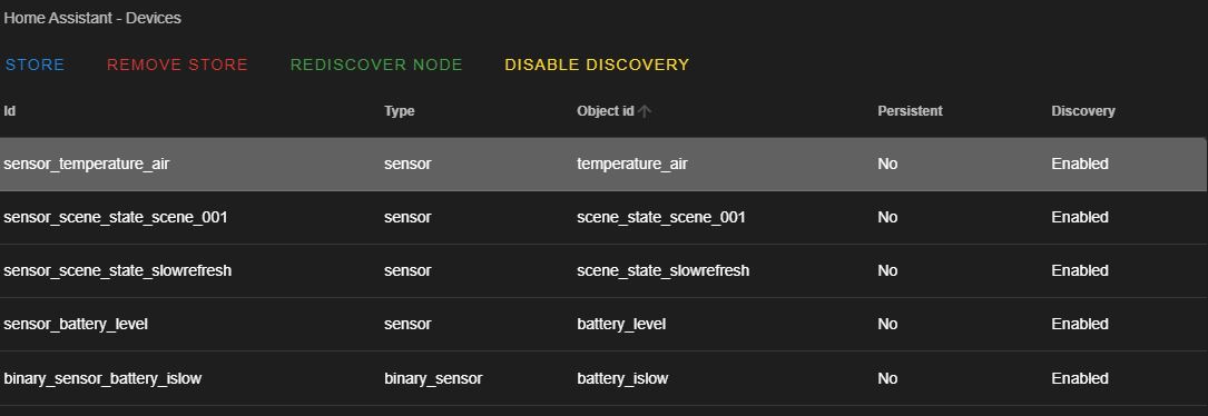

I have recently migrated from OpenZwave to ZwaveJS. I have also enabled MQTT auto discovery and everything works as expected except one thing.
My Danfoss DRS21 Thermostat cannot be operated from Domoticz. I am able to read temperature and set the setpoint from the zwaveJS UI but there is no device created for setting the setpoint from Domoticz. I can read the temperature though.

So that is an issue on the Zwave JS side? Can you see the setpoint in Zwave JS? If not then check Zwave JS issues.

Yes i am able to see the setpoint and update values fine but there is no device created for that purpose.

Then you have to send the related MQTT topics payloads. See https://www.domoticz.com/wiki/MQTT#Debu ... er_devices and make a github issue with that in https://github.com/domoticz/domoticz/issues
It is strange though that you have a screenshot of Zwavje JS without the requested setpoint device....
