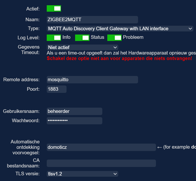

I've been working for days now to get Zigbee2MQTT working within Domoticz, but so far it hasn't worked.
I followed the wiki for installation (https://www.domoticz.com/wiki/Zigbee2MQTT). Three docker containers are now running with Domoticz, Zigbee2MQTT and Mosquitto. These run in the same docker network so that they can connect to each other.
In Domoticz I have set everything under hardware as stated in the wiki:
To test I created a temperature device. When I send a test message from the Domoticz or Zigbee2MQTT container (with mosquitto_pub -h mosquitto -m '{ "idx" : 184, "nvalue" : 0, "svalue" : "25.0" }' -t 'domoticz/in ') it is received by the Mosquitto container. But in Domoticz the temperature device is not updated. It seems that Domoticz is not receiving the message, but I can't find why.

Did you change the settings in Zigbee2MQTT because the default topic name in Zigbee2MQTT is "homeassistant" (instead of "domoticz")

Thanks waltervl!
I changed the 'Automatische ontdekkingsvoorvoegsel' to homeassistant and in the configuration.yaml of zigbee2mqtt set homeassistant to true instead of false and now my devices become present in Domoticz.
