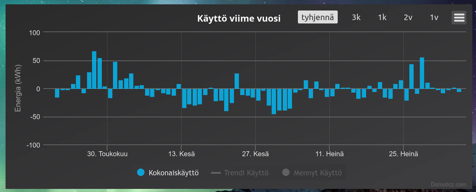

Interesting thing is, normal kWh counter already supports negatives, no issues there. I think you could just leave units at kWh and pretend they are euros. However if you change counter type to "custom" so you can change units to €, negatives no longer work.
Proof of the kWh negatives thingy, my kWh readings from last summer:
Kuvakaappaus 2022-12-05 09-35-02.png (118.73 KiB) Viewed 1063 times
