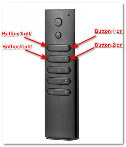

I have a sonoff Zigbee Bridge Pro and I have a Zigbee 8 button remote. When I press the buttons, I get the following rules back in console.
Domoticz does not understand this. Domoticz expects an IDX. I have made a rule that works, but there is Power=0 in all left buttons and all right buttons contain Power=1.
If I apply the first rule, the switch listen to all 0 and 1 buttons. If I make a rule with Group=16358 then I can only switch or off with the first button, because they have the same group.
Button 1 -off
MQT: tele/tasmota_10C440/SENSOR = {"ZbReceived":{"0xAB80":{"Device":"0xAB80","0006!00":"","Power":0,"Endpoint":1,"Group":16385,"LinkQuality":153}}}
Button 1 -on
MQT: tele/tasmota_10C440/SENSOR = {"ZbReceived":{"0xAB80":{"Device":"0xAB80","0006!01":"","Power":1,"Endpoint":1,"Group":16385,"LinkQuality":142}}}
Button 2 -off
MQT: tele/tasmota_10C440/SENSOR = {"ZbReceived":{"0xAB80":{"Device":"0xAB80","0006!00":"","Power":0,"Endpoint":2,"Group":16386,"LinkQuality":142}}}
Button 2 -on
MQT: tele/tasmota_10C440/SENSOR = {"ZbReceived":{"0xAB80":{"Device":"0xAB80","0006!01":"","Power":1,"Endpoint":2,"Group":16386,"LinkQuality":142}}}
