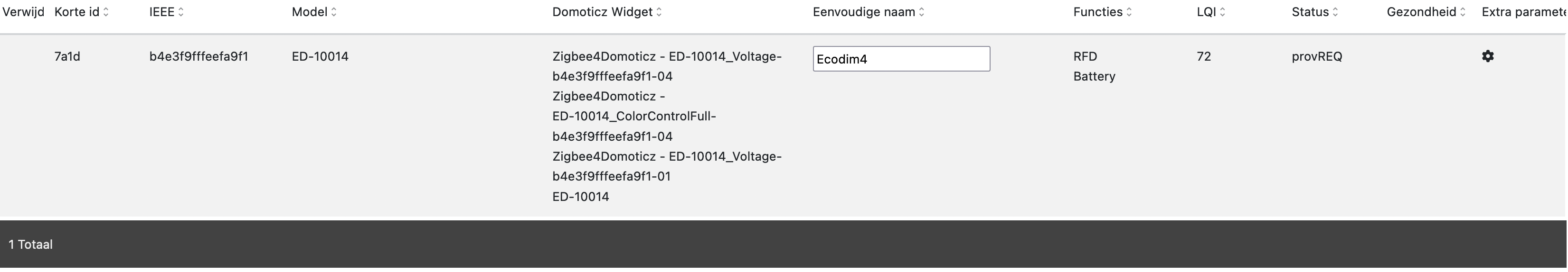

@pipiche I am trying Z4D on a spare system right now.
I encouterd some issues with installing thru the python plugin manager.
Needed to fix some stuff manually before the sonoff stick was detected and working.
The plugin directory is called "Zigate" if installed thru ppmanager for example.. not all needed python modules where installed.
The "integration" page in domoticz is not working. just a blank page.. need to go to the 9440 page manually
I tried to pair a divice and that seems to work but not all is working as expected thru the 9440 interface
Screenshot 2022-12-04 at 09.47.20.png (363.53 KiB) Viewed 1087 times
like I expect a checkbox in from of this device ...
Also the device map only shows the coordinator, not this device ...
It could be that I am missing something, still trying to find and read documentation on how to setup things

tried on FireFox latest and on Safari, both same results
Looked in the source of https://192.168.2.200/#/Custom/Z4D page and there is not a sign of the Z4D content
RPI4 Beta / Tasmota / ZigBee2MQTT / P1meter / Haier AC with Node-Red and MQTT / SolarEdge SE3500H modbus_tcp / Opentherm gateway / Plugwise Anna/Smile / ObserverIP weatherstation thru WuDirect

Sorry, I didn't understood what you were looking for.
So if I understood your issue, you cannot access the plugin WebUI from the Domoticz Custom menu, is that correct ?

eddieb
Posts: 340
Joined: Wednesday 04 July 2018 7:48
Re: migrate Z2M to Z4D
Post by eddieb »
That is correct
in the domiticz dropdown "Custom" is an entry created "Z4M".
clicking on that entry gives a blank screen.
accessing port 9440 directly works.
