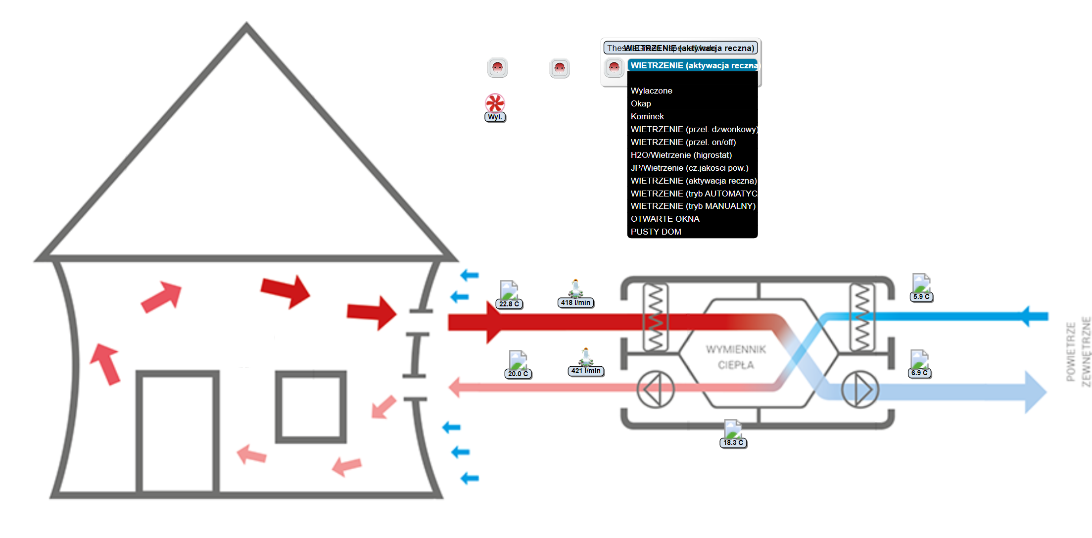

I have developed domoticz plugin which helps me integrate my ThesslaGreen recuperator over RS485 modbus connectivity (available even as basic functionality of the device).
https://thesslagreen.com/product/airpack4h/
Plugin should work with all AirPack family models, however was tested only with AirPack4 500h
supported functionality -
reading temperature: outside, supply, exhaust , fpx, duct_supply, gwc, ambient
reading AirFlow: supply and exhaust
Possibility to turn on/off, read/set special flow mode.
Plugin is available to download from
https://github.com/voyo/ThesslaGreen-modbus

ThesslaGreen recuperator integration - plugin
- reku-plan.png (372.89 KiB) Viewed 2903 times
