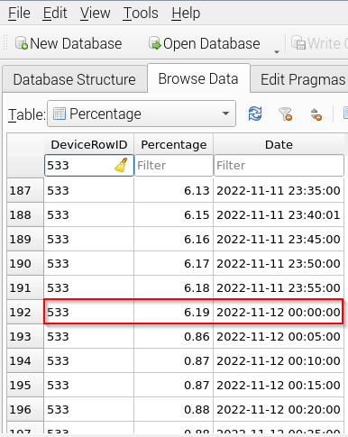

I have a script that calculates the costs of power and gas consumption. The problem is it set the highest value at 00:00 hour. See screendump.
That will result in a Dashticz Graph that shows this value at the next day. See screendump graph1. The top bars are consumption and the bottom two are the costs of consumption. Use on the 12th of november is at a minimum but the costs are equal to november 11th. After editing the idx 533 and 534 in de database, the graph is correct.
As shown in Graph2 screendump after editing the value of gas, the costs on november 12 are only networkcosts. Before I edited the value it had the same value as november 11th.
Whats is wrong with the script or Dashticz that this issue happens.

Post by drasnirp »
Solved it by running a script that edits the value. This script uses sqlite3 to edit the wrong value at 00:00. Tested and works fine. Case Closed.
